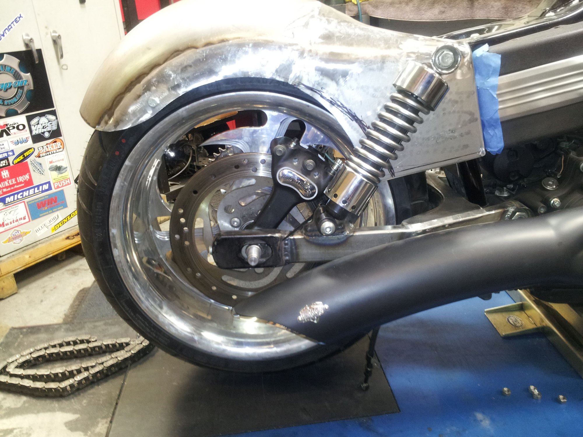

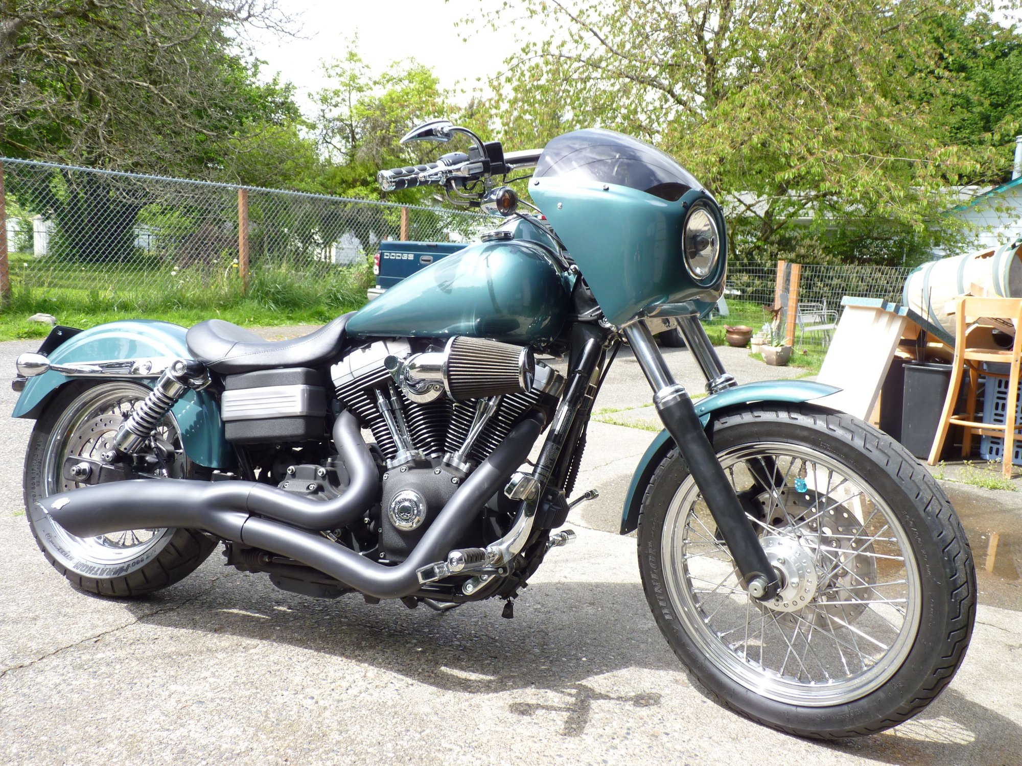

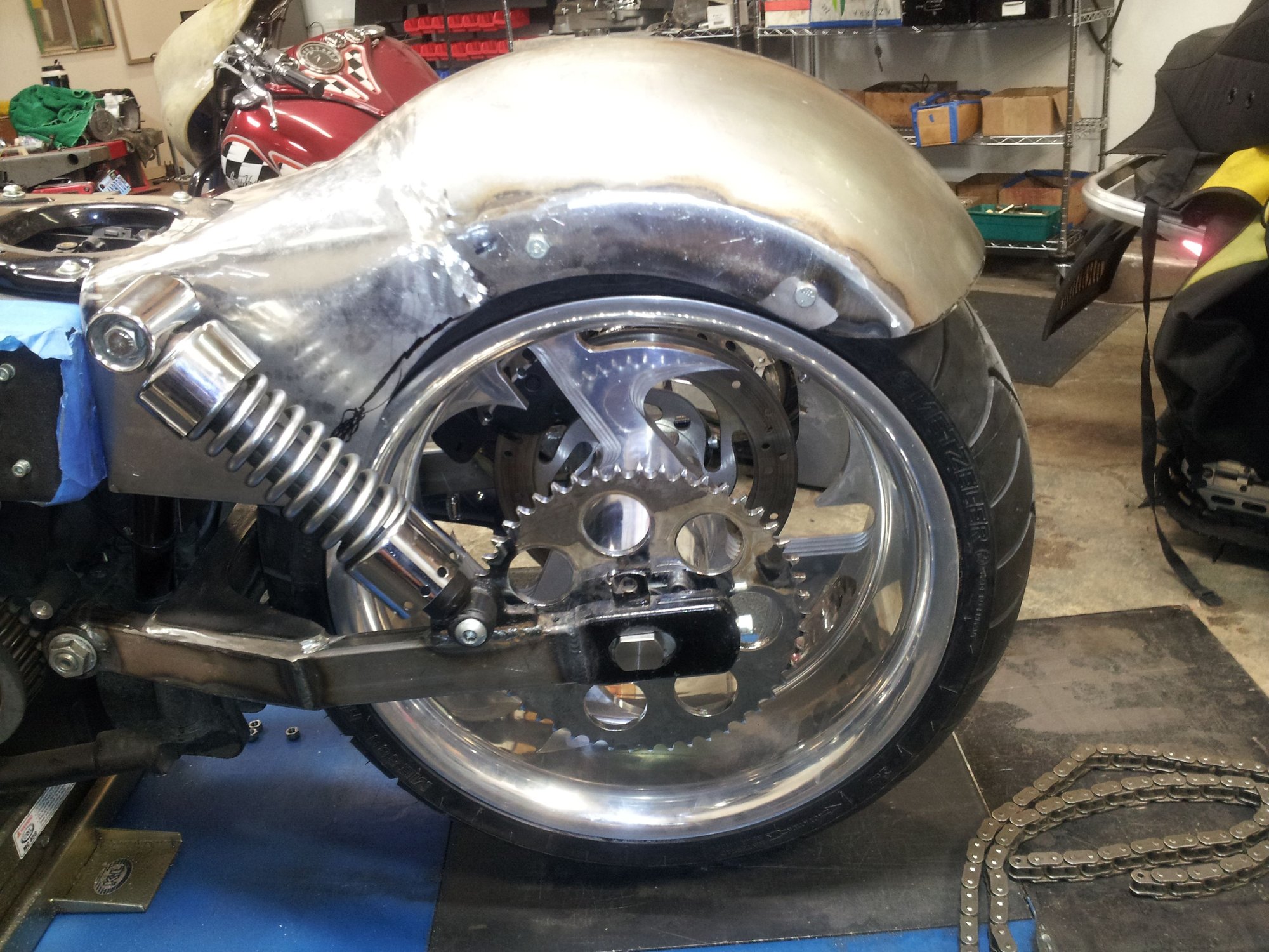

Default 2006 need new transmission shaft
I just did my fat tire kit on my 2006 street bob and had to get special shaft for the transmission . due to them using belt instead of chain so if your thinking of doing a fat tire kit on a 2006 street bob know it will be about 1000$ more due to this shaft in the tranny problem. here is a couple pictures from when I bought it last year and what it looks like now before fat tire kit. I am also adding full size road king bags painted the blue green my bike is now new rims tires forward controls and heat demons . need to still do my levers and controls and my shocks . pretty excited its been in the shop for 6 months ill have it back June 1st . ill put up more pics once its done . hope you guys like the color and what im doing . I never in my life thought id own a bike much less the gorgeous bike I have
