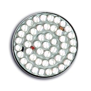

Does this look the right ones?
"><img src=" /> ">
by Radiantz 5.0 out of 5 stars See all reviews (1 customer review) | Like (0)
List Price: $29.99 Price: $26.99 You Save: $3.00 (10%)
Special Offers Available Special Offers Available
Product Features
  • Dual Intensity 1157
  • Ultra-Bright Red LEDs
  • Wide Angle
  • Easy Plug and Play Installation
  • 1-year Manufacturer's Warranty
Originally Posted by SLV
BTW. You'll need dual intensity for 1157 style bulb replacement.
Attached Thumbnails Rear signals/running lights not working-514pbnk9gsl._sl500_aa300_.jpg

Yep. That's it. Great product and price.

Ordered a pair this morning, hopefully all goes well!
