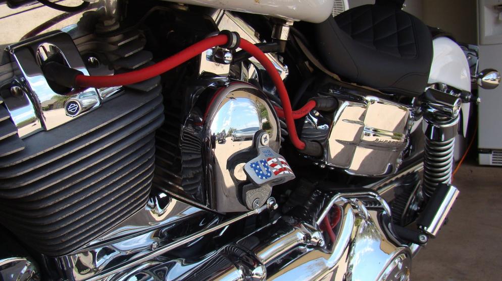

I went with the Kuryakyn ISO Boards (part # 7916). Had them on for 2 years and love them. I can adjust the angle of the Boards to whatever I choose. The adapters tend to loosen up over time so I tighten them about every 4-6 months.
Since they mount where the forward pegs go, they allow me to stretch out more than if I had true floorboards. They do push you out about an inch (which at first seemed odd, however, since I have the Big Sucker II and a bottle opener on my horn cover, I need the extra inch so I don't rub my inner thighs).
Here are some pics:
