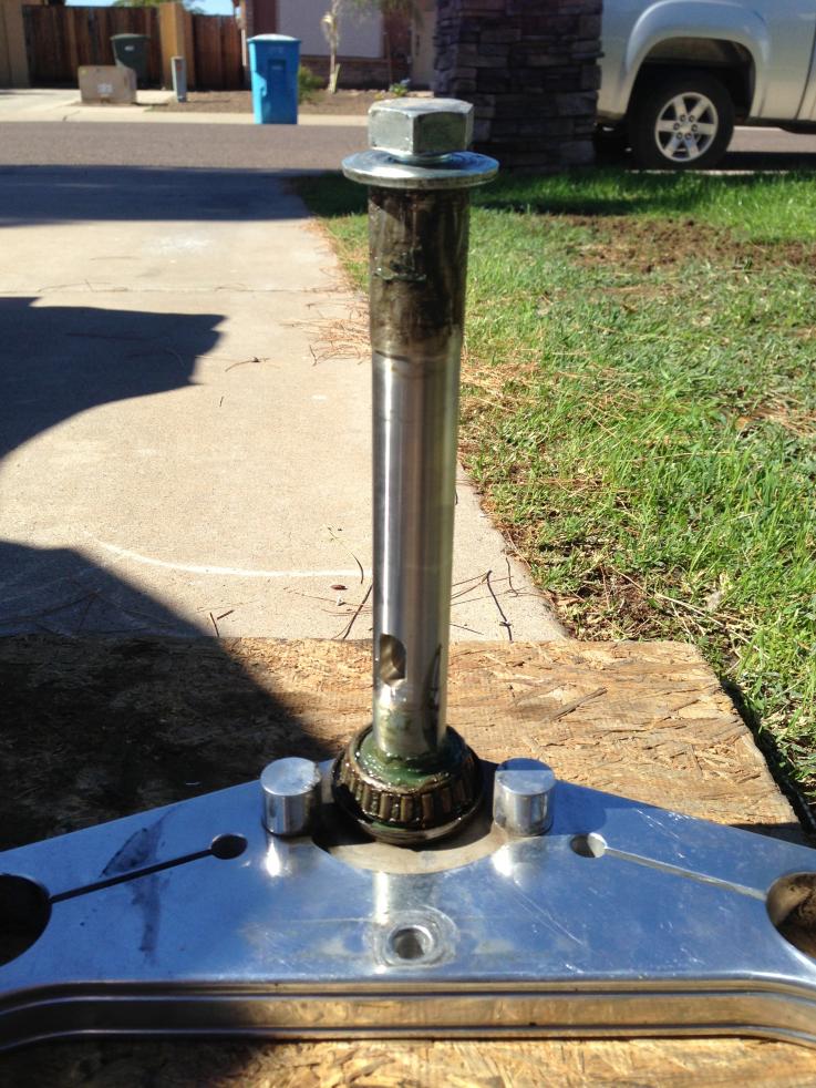

decided to get at it again today, tore the whole front end apart, as I'm trying this lock I realize the stem is probably twisted past the point where the lock engages it, I'm trying to rotate the stem in the lower triple clamp but can't get it to turn, there is a milled oval shaped hole in the stem which tells me HD may have made a special tool for this, manual doesn't address in the steering head section, any ideas?

here is what I mean, looking at it from this angle, I think the stem needs to rotate counter clockwise until the milled slot (not oval) lines up with the lock, I threw it in the freezer to hopefully get the steel stem and aluminum clamp to contract from each other

AH HA! I figured it out then chatted with the service dept of Scottsdale HD and got it fixed, on a bad note, I beat the stem out of the lower bracket which resulted in messing up the 1/4" threaded hole for the brake fluid distributor which is hanging by wire till I fix the threads BUT, got that damn stem aligned and lock installed which I must say is smooth as eggs, in this pic you can see to the left, the factory "notch" for the set screw indicated alignment, then as you look to the right you'll see the screw had "floated" and carved a groove in the stem and its a little blurry where it finally ended up, its beyond me why whoever serviced it didnt align it and didnt notice the factory notch but that would've saved some trouble
