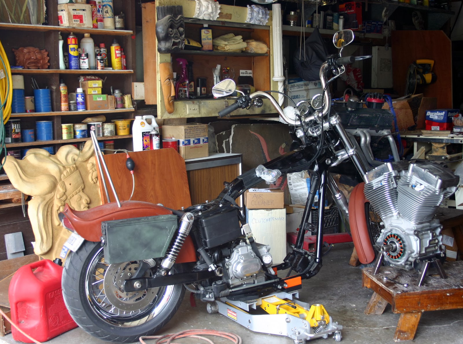

1. Do you guys leave the engine and transmission bolted together when you remove it from the frame? Is it possible that one man with a light weight helper could assist with?
I would recommend separating the engine/trans
hang the trans from the backbone
one man can easily extract the complete engine
have a place handy to set it down.

When I pulled my motor from the frame, I took off the primary. Unbolt everything, leaned the bike over on its side, then lifted the frame. I use the same technique for reassembly. Its much easier to maneuver the frame than the motor.
