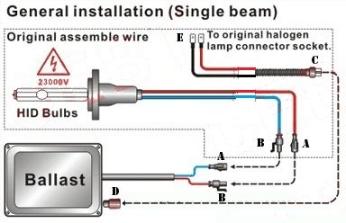

Hi,
Is this how they connect? Or is there an easier way
Thanks

none of mine go to the battery, they are not relay harnesses, on my HD i never saw a need for them. i order all my hid stuff from ebay, xentec stuff works great and is only like $30 or so.
I do keep spare ballasts on hand just in case (you will have a spare ballast and bulb with your kit if you order a car kit as they come with 2)
my truck runs DTRL so i did have to do a relay setup in that to prevent flicker. works just fine.

Here's a quick pictorial I just made explaining the different types of set-ups:
DDM sells the motorcycle low beam only kits for $22.50, but if I had my time back I would of ordered the car H4 kit. That way I'd have a spare ballast and bulb which is only $30... Live n' Learn haha!
Joe does your H4 bulbs have the little metal shroud on them to block the light from reflecting off the bottom of the housing?
Also did you leave the little round shroud in the factory headlamp in place?

yes sir they do, yes i leave the deflectors on stock HD lamps, but on mine i have none. your pics have a relay setup that needs conected to the battery not bad at all and prevents flicker on some vehicles (sport bikes this is needed) HD's i have not run into any issues on any i have installed
I'm gonna run the HID setup without the relay harness at first and see how it performs. Assuming it won't flicker or overheat, i'll leave it as is.
If it ends up posing any issues i'll hook up with the relay harness.
