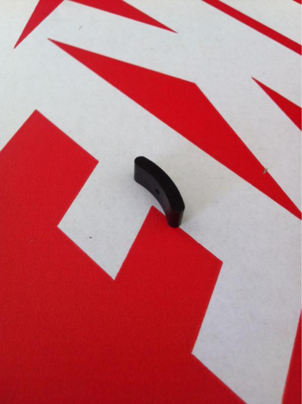

Did my handle bar swap today on my '14 street bob, this piece of plastic popped out when we removed the throttle cables but don't know where it goes... Anyone know what this piece is and we're it goes?

It goes inside your throttle handlebar assembly, sits on top of your throttle adjuster screw

aw yes, that piece... i lost mine when i switched my bars a couple years ago
you know the screw under the controls?
well it goes where that is on the inside, under the throttle grip - the screw pushes that piece up against the throttle to increase the friction or something. i've never felt like i'm missing out...

Yep, that is the Amish contribution to Dyna cruise control.
The silly thumb screw throttle lock screws into that and that is what holds (and I use that term loosely) the throttle hand grip in place.
