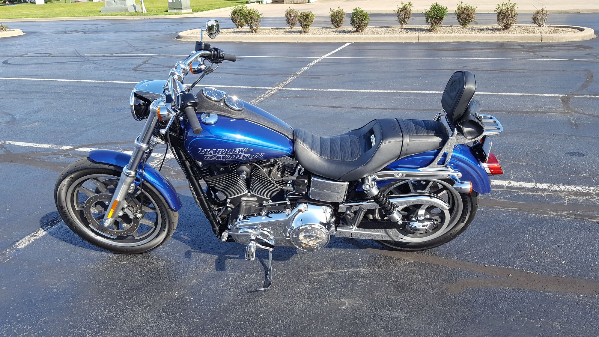

Sorry but the above pic's is my 2016 Low rider with 120R . I love the power and response.
