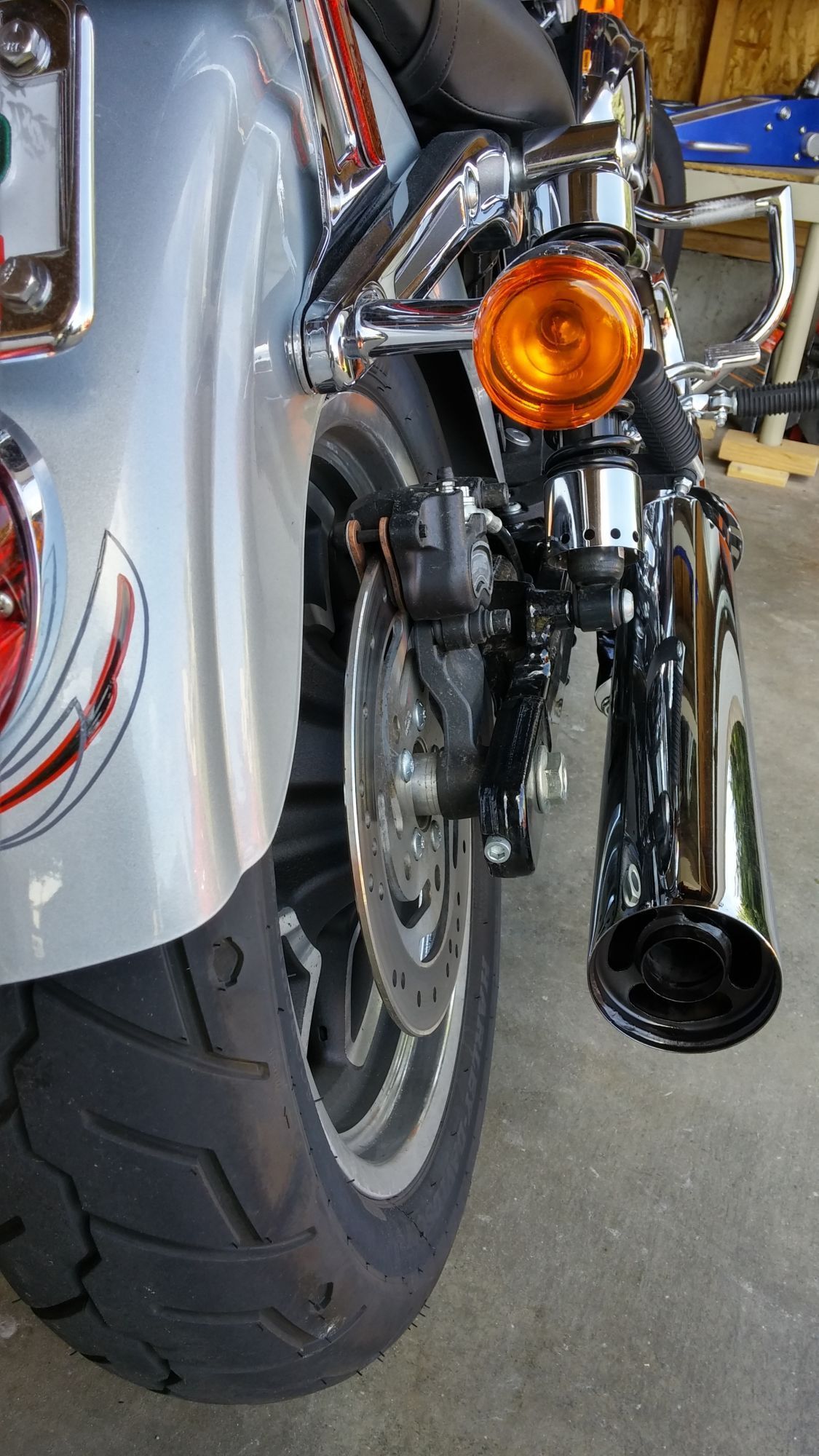

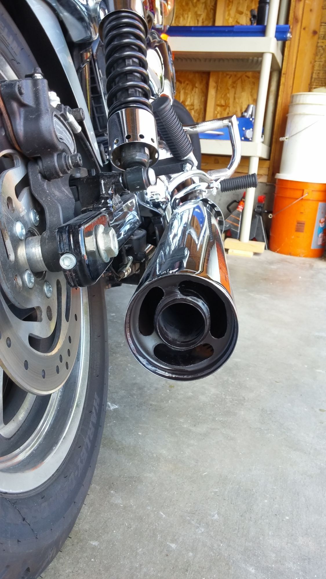

I was thinking of adding holes in th 5-6" space at the end of the baffle that is solid. Couldn't get a drill in there but thinking a mini-grinding wheel could be used to create slots in that area which should open the baffle for more flow and sound ... sort of like the gronk mod to sporty baffles (http://www.xlforum.net/vbportal/foru...ad.php?t=16948). Even better - I think this could be done (with slots instead of round holes) on ours without removing anything.
Update = tried slots inside and couldn't make that work. Instead I opened up the space around the middle open part of the muffler. Like it a lot so far. A little more rumble at idle/cruize and quite a bit more when twisting.
Pics are in my album.
This one is direct on
And what you see when standing

Did modifying the muffler make it run any hotter? Mine seems a little lean already.

Good question!
I can't say. It already cooked legs when sitting at lights - now maybe a little more?? Air coming out the exhaust seems rather more forceful but again, hard to tell.
I wasn't too worried as I have stage 1 AC to put on - just waiting on tuner decision. It seems the problem then will be figuring out what map to start with that reflects this muffler configuration. From what I've seen inside this and my old sporty days it seems like this is most similar to what V&H calls their quiet baffle.
