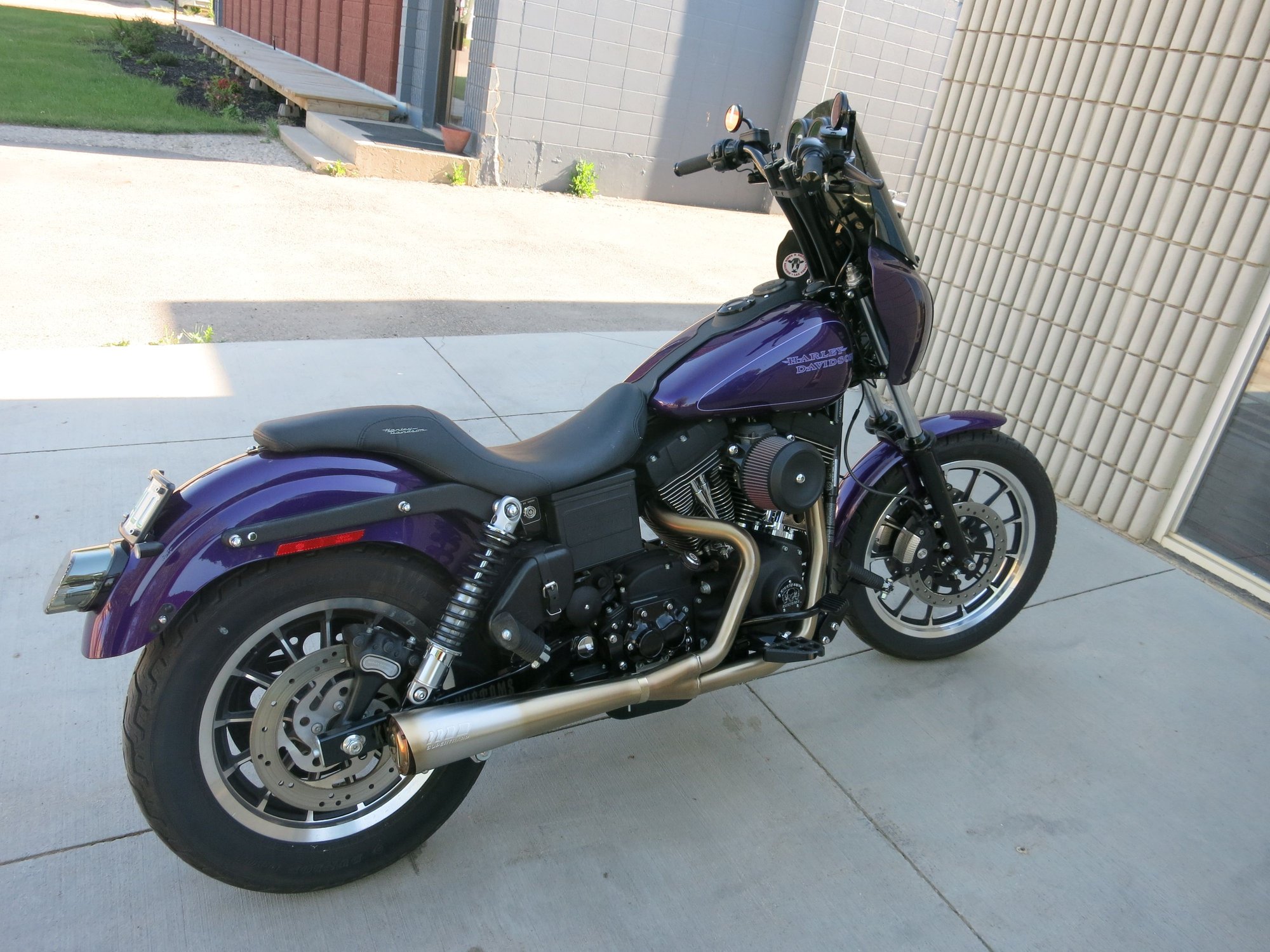

Brushed stainless Supertrap 2-1 and a S&S open air cleaner.
Done for this year.
Beautiful. That's a really clean, well done bike. Looks like you didn't cut one corner whatsoever. Very nice, man!
Think we can get a sound clip? Let's hear it!

Gawt DAyum. That thing is beautiful. Didn't go overboard with blacking it out or lowrider paint. Everything is clean and sano and functional. I love this bike. Perfection. And you're running a stainless ST which I've now grown to love since my FXR came with one.

Unbelievable job, just in time for a nice Sask. Summer! How does it ride?
Rides great. the work I did on the forks realy helped. I am sure that the fork oil was never changed before I did it and i also thoght the forks were a little spongy
for my tastes.
The San Diego Customs mini floor boards are money well spent, very comfortable.

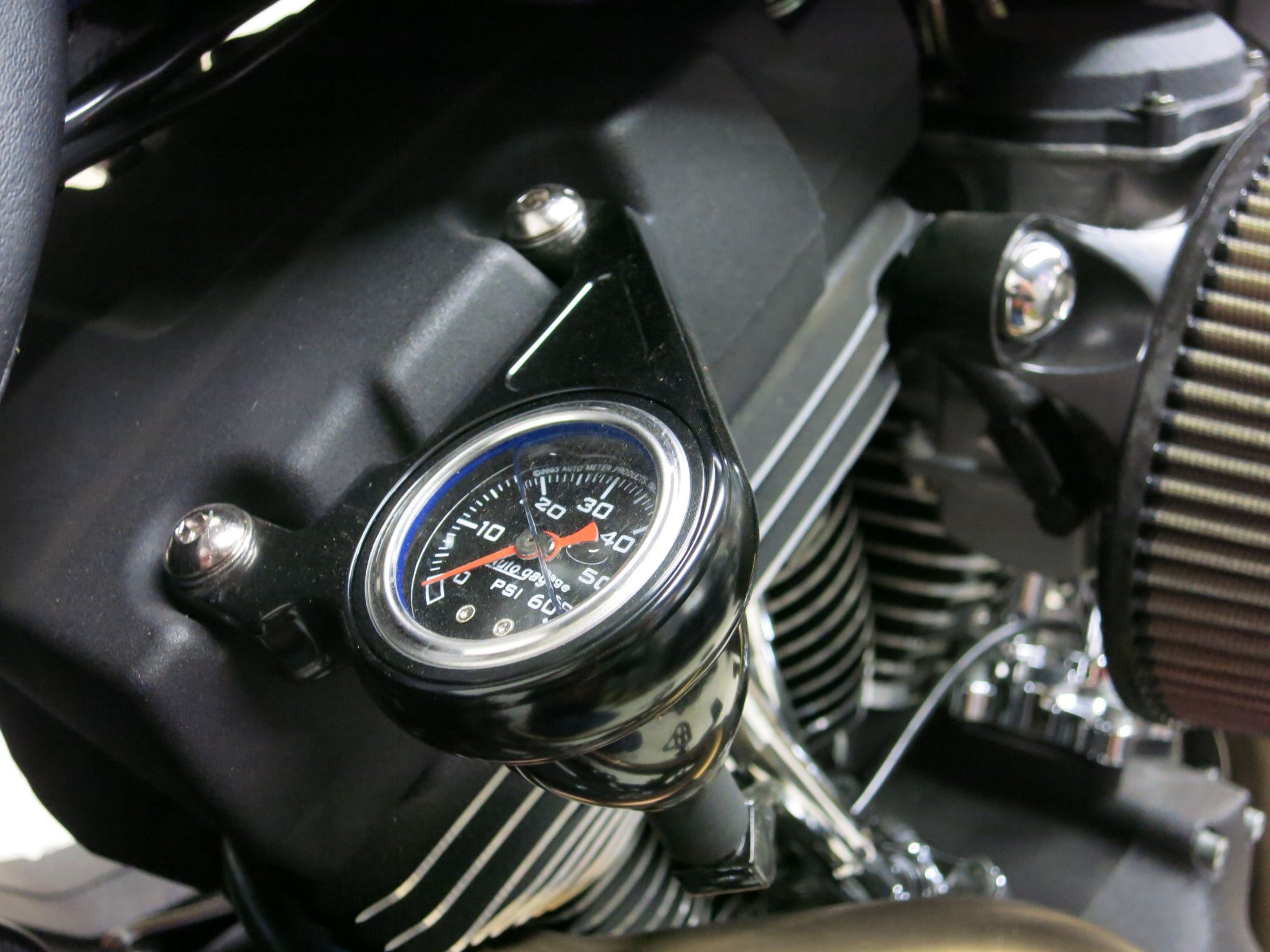

I added this modified Ness oil gauge kit to my bike just before leaving for Sturgis for the 75th.
I didn't want to use the Ness gauge or the braided stainless line that the kit came with.
I had to machine out the bore of the cup that holds the gauge to make room for the slightly larger autometer gauge. I then made my own line using the goodrige Sniper lines.
