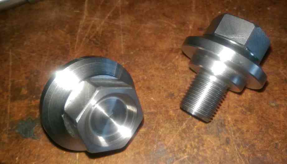

IIRC you got a machine shop or at least access.. Make one of these. Steering bolt for FX forks.. Get rid of that damned cover.. Much easier to mess with steering bearing tension. Thread is a common 9/16x18..
These are made from 1 1/2 inch 416 SS bar.. 316 probably been a better choice but the 416 was layin around.

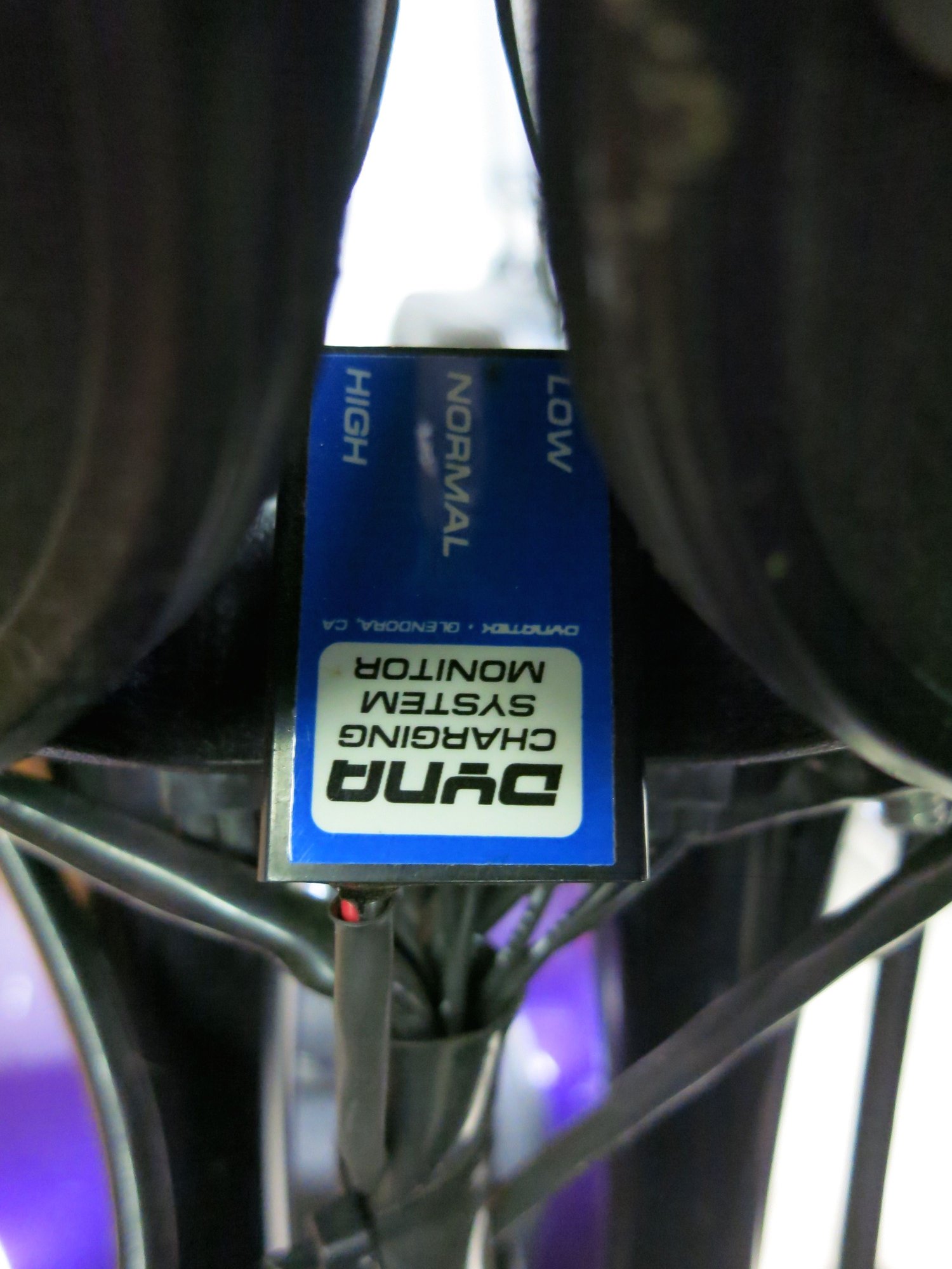

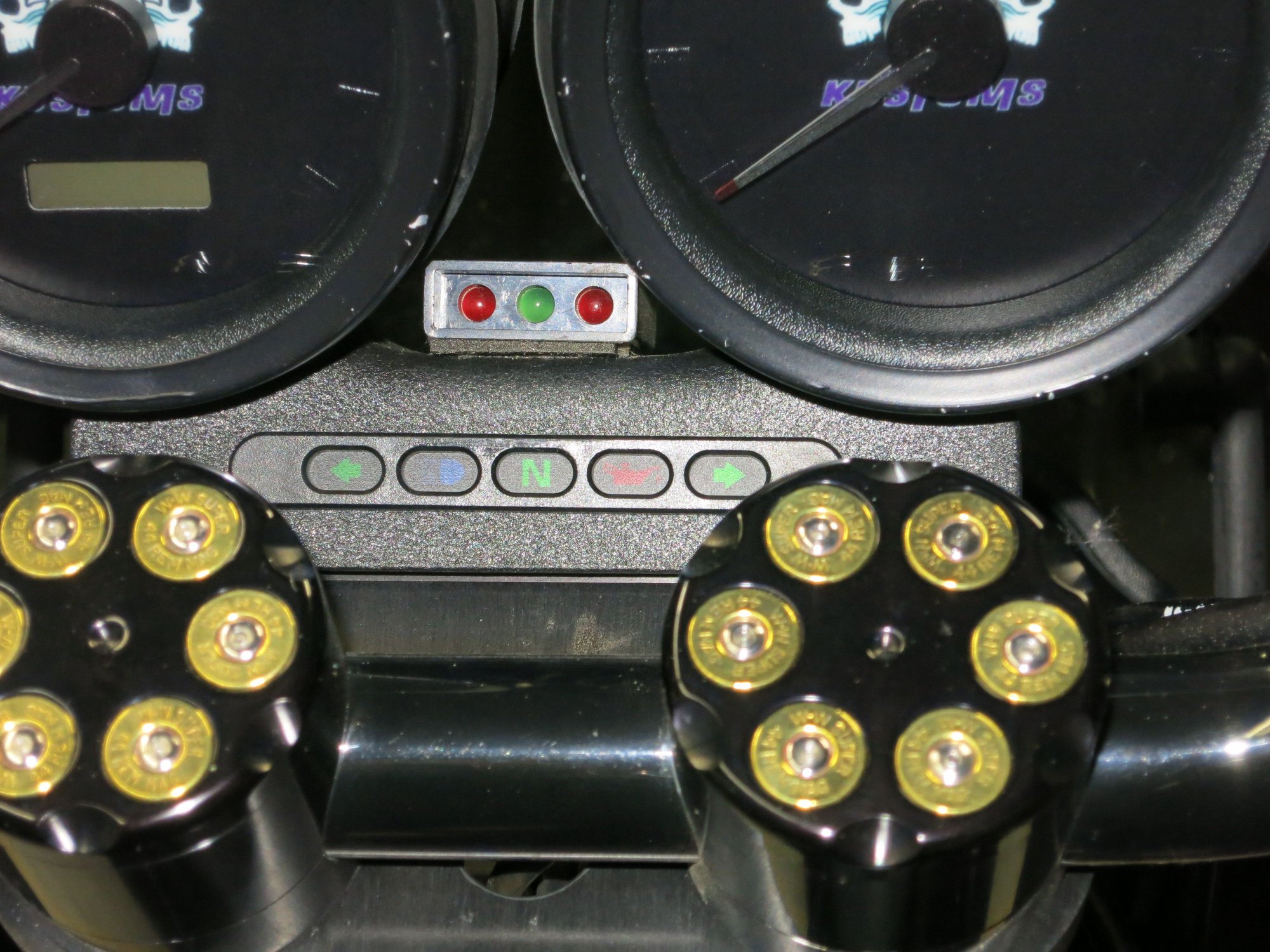

Here are a few things that I got done this past winter.
My better half had a stater fail on her bike so I decided to put a charge moniter on both of our bikes.
I put the dyna version on my bike they are small and very simple to install.
I mounted it between my gauges where it is easy to see.
Mounting is simple 3M two sided tape.

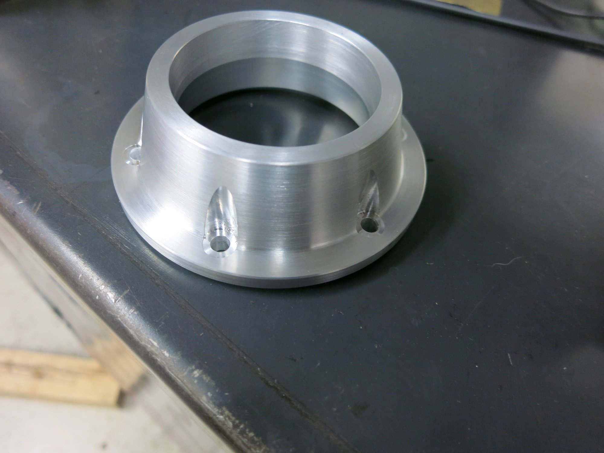

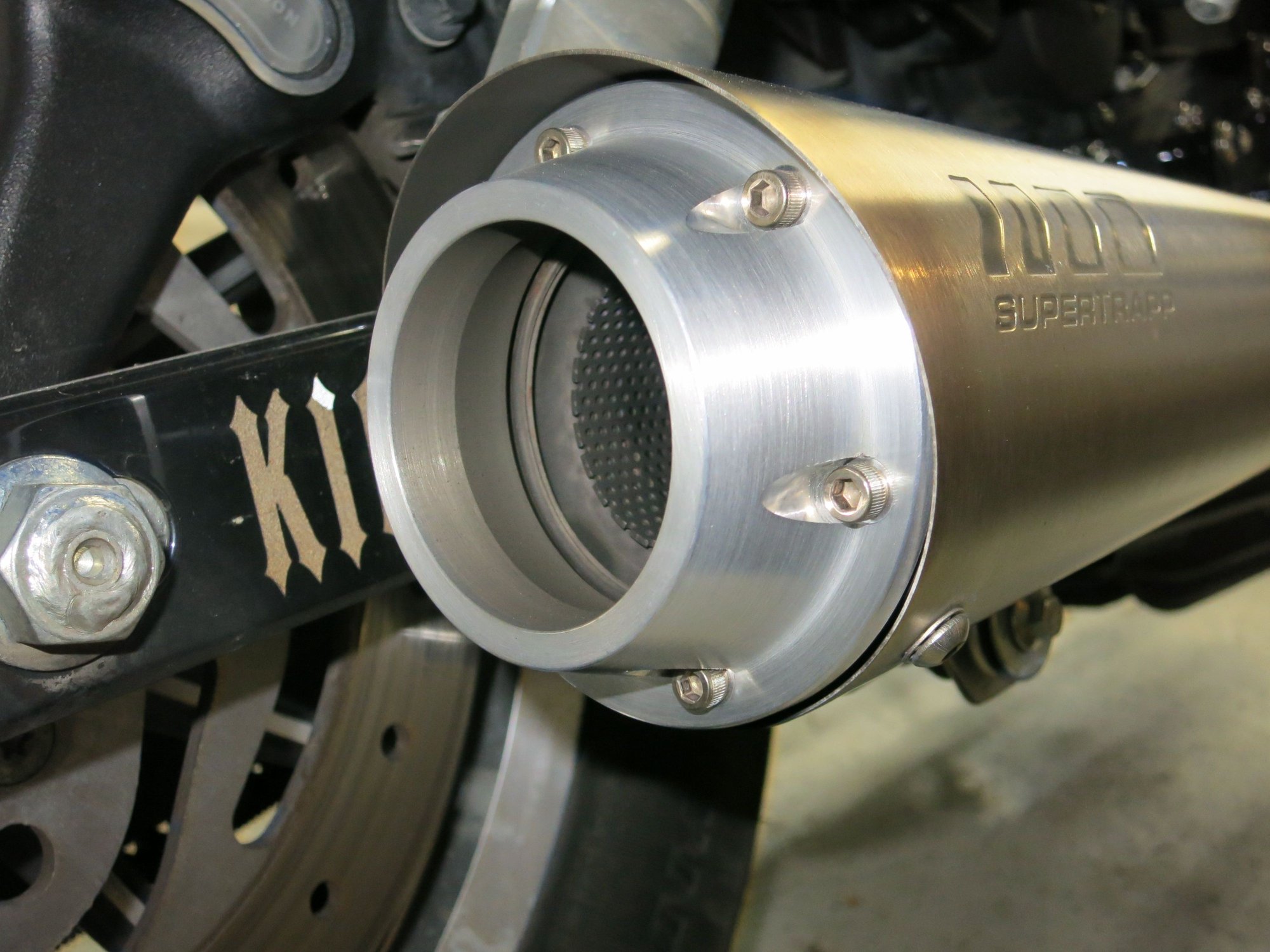

I machined up an open end cap for the pipe.
Just wanted to try something different than the closed cap.
The sound at idle didn't change much but was quite a bit louder when you hit the throttle as expected.
Also noticed a little loss of low end torque

Originally Posted by Tat2dale
I machined up an open end cap for the pipe...
You could always machine up some different reducing inserts to play with the back pressure
...Nice job
Old Jun 16, 2016 | 08:26 AM
  #110
Tat2dale's Avatar
Tat2dale
Joined: Mar 2014
Posts: 201
Likes: 12
From: Canada
...Nice job
Yes I can.
This is why I think that these pipes are the best you can get because they can be tuned .
And thanks.
