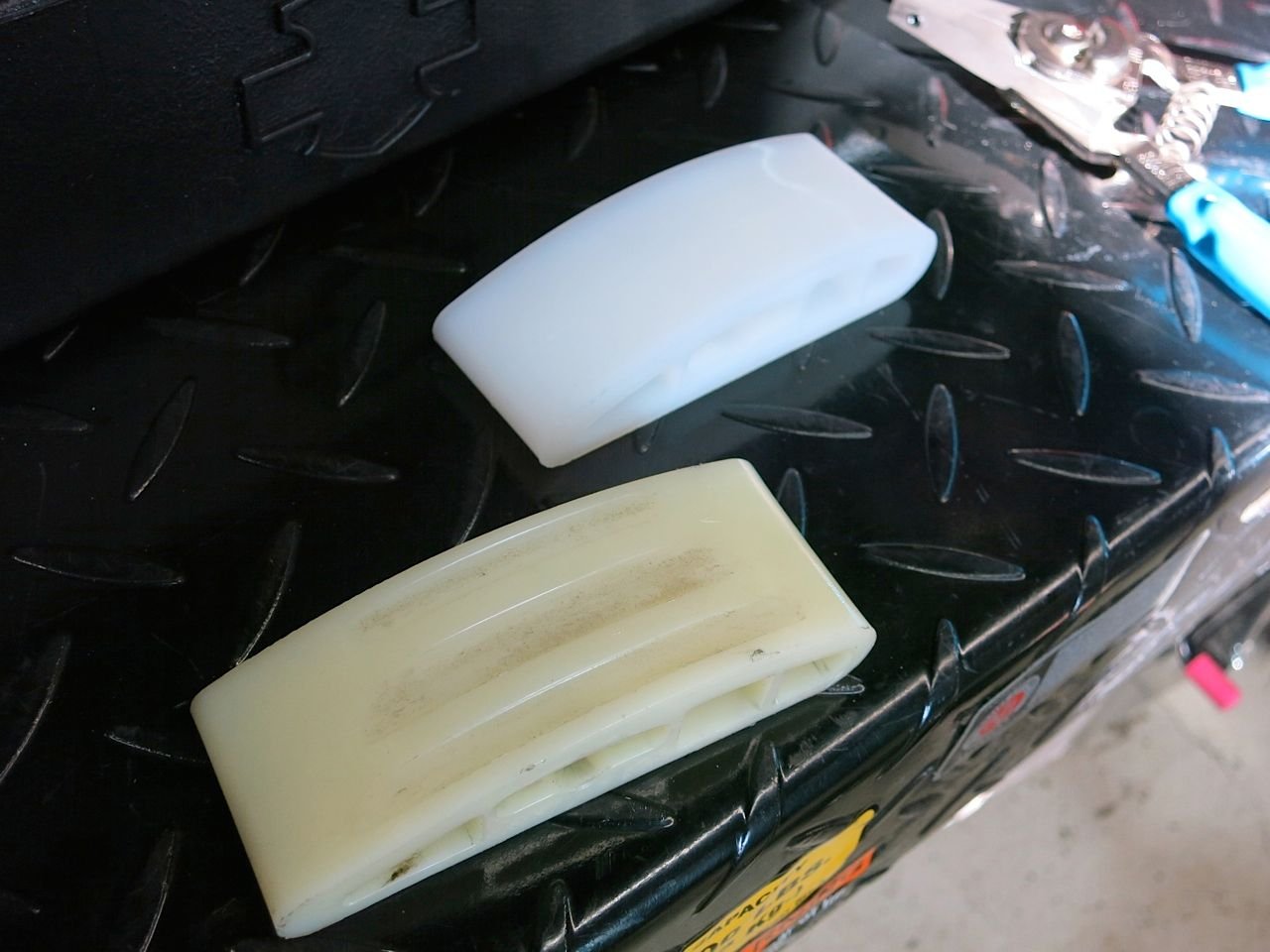

Well I started the winter mods this past week.
The first order of business was to open up the primary and replace the clutch spring with a barnet heavy duty spring. This will be needed to handle the extra HP/tork gained from the S&S big bore kit.
The primary chain tensioner showed some signs of wear so I replaced that as well.
Also changed the o-rings on the shifter shaft sleeve.
Hope to finish the motor tear down this week providing I have the time.
