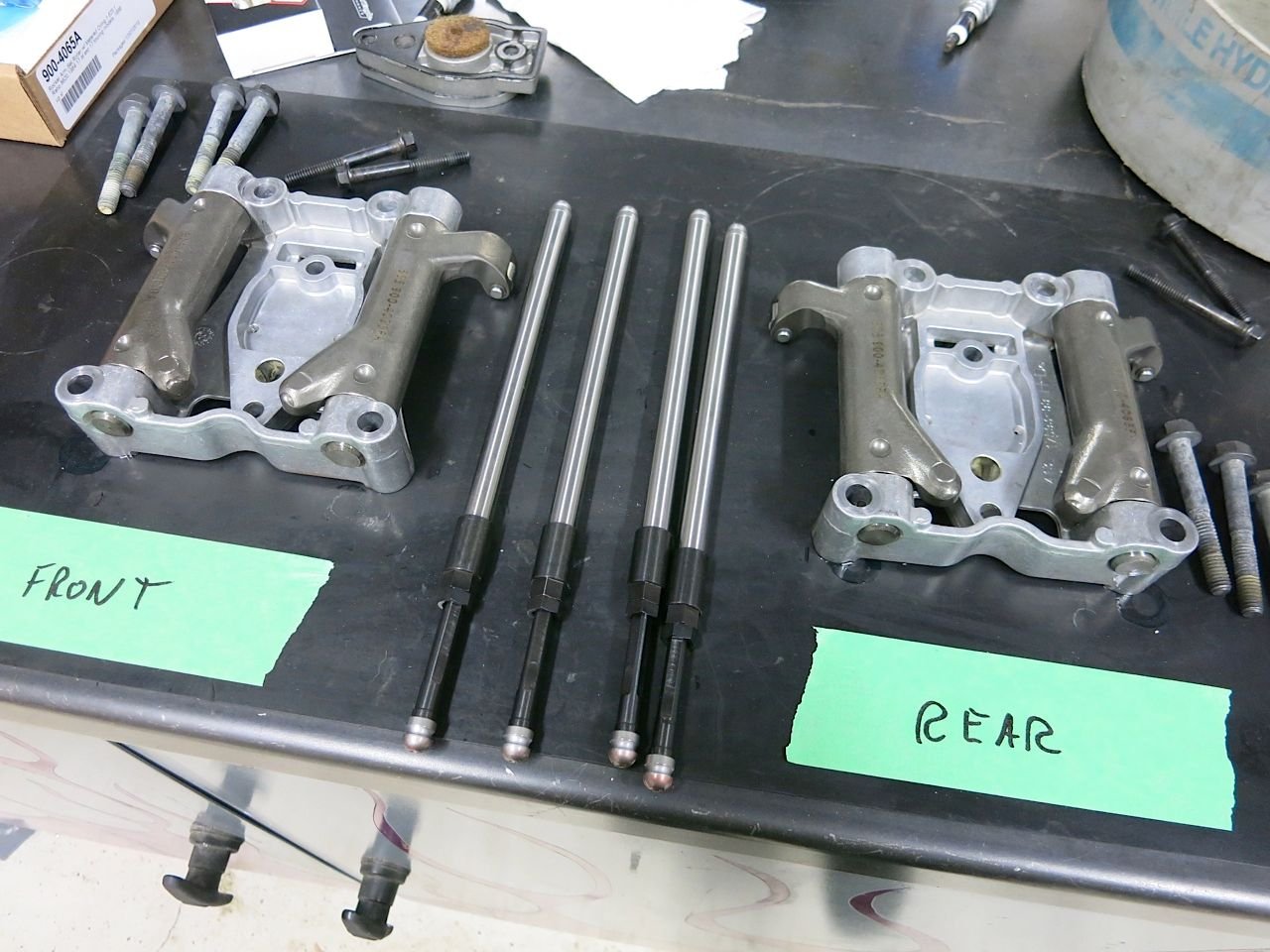

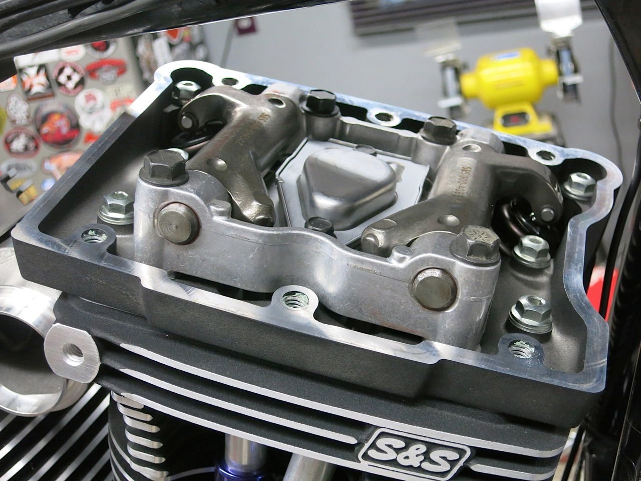

Next up was the rocker arms and pushrods. I went with S&S roller rockers that probably were not needed with this cam but didn't think it would hurt. Also put in new rocker shafts as well. Pushrods are S&S quickys.
The rocker arms were hiting the top of the top rocker box cover so so removal of some material was needed in the rib area of the top cover.

Motor is all together.

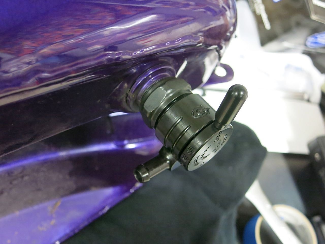

I replaced the stock vacuum activted 1/4" petcock with a Golan high flow 5/16" petcock.

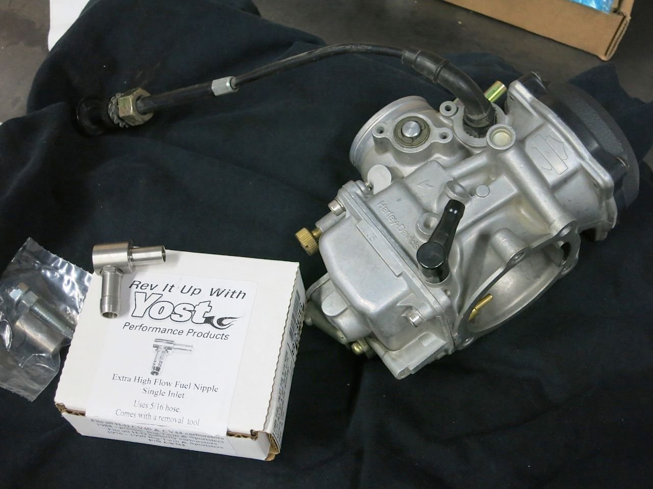

Next up was the fuel inlet on the carb. I removed the stock 1/4" inlet and replaced it with a Yost 5/16" inlet. Very easy to do no issues.
