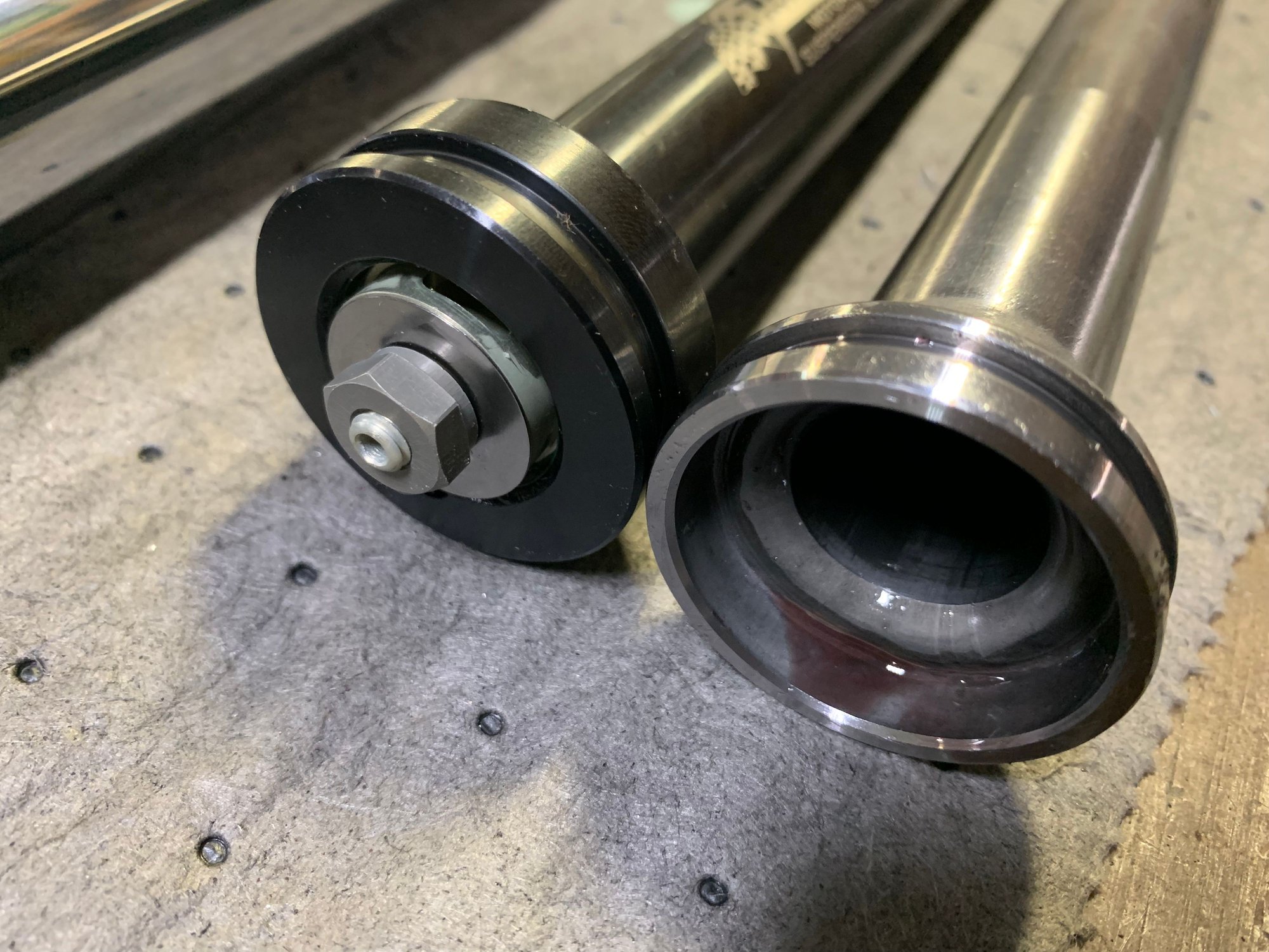

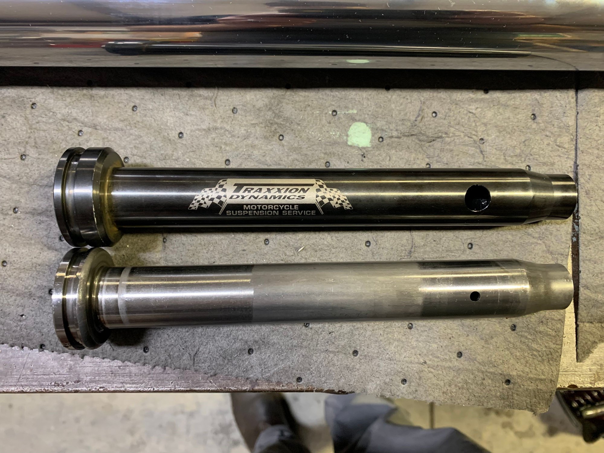

I recently rebuilt my 2012 FXDB forks with the Traxxion kit. Same noodley soft feeling up front as you. Some debate over progressive rate springs vs single rate with valves, Im firmly planted in the later, amazed by the difference in the AR25 kit in my bike.
https://traxxion.com/product/ar-25-a...per-kit-s41-3/
Here’s a couple pics of the difference in my stock damper rod and the ones that come from Traxxion with the valve built into it……
