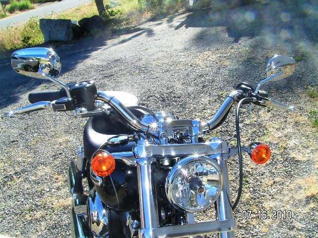

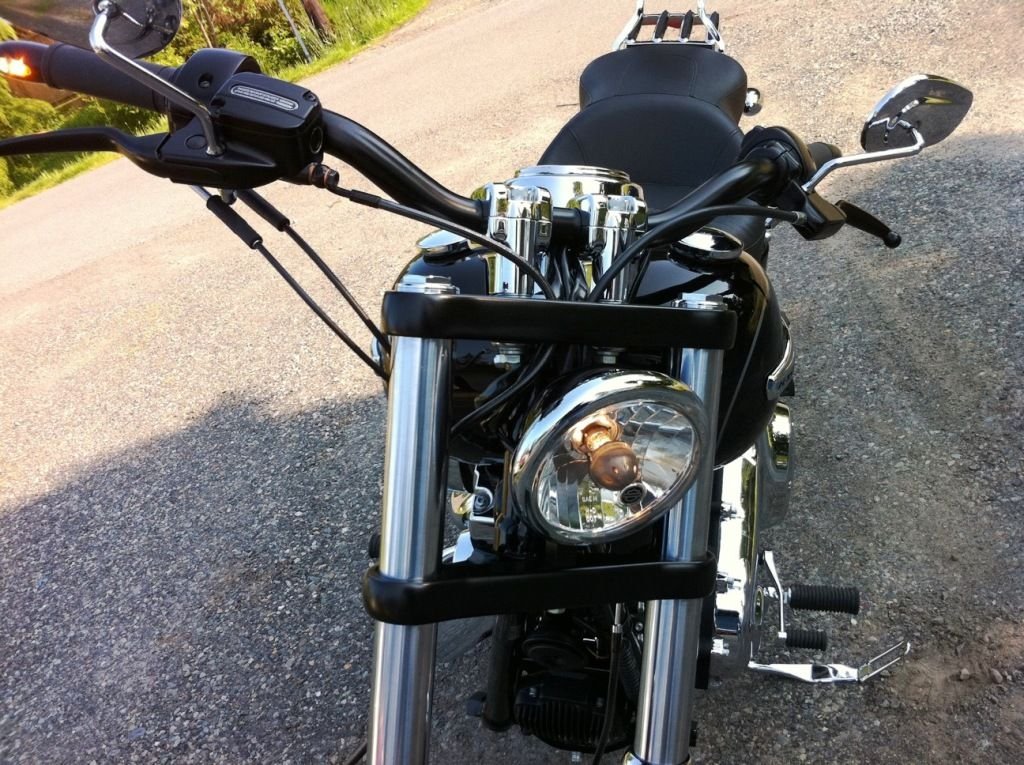

You'll find that the Low Rider bars and the Wide Glide bars are pretty similar in bend, major difference being the LR is 1" and the WG is 1.25" meaning you will need new risers.
On mine, I put the LR bars on first but switch the the WG ones when I put Fat Bob trees on - I used stock Fat Boy Lo risers and they worked great. Keep the wires outside on the LR or put them inside with the WG.
Low Rider bars with stock risers
Wide Glide bars with FB lo risers
