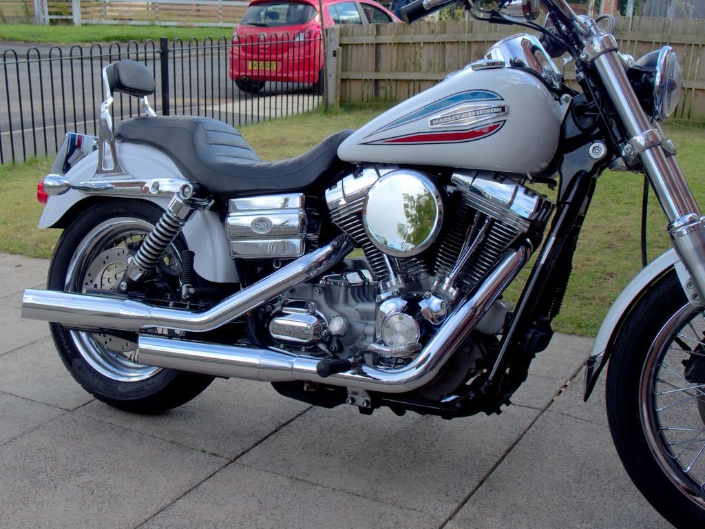

I put a 7 inch round air cleaner cover on my 2009 Night Train that has a Screamin' Eagle stage 1 air filter set up on it. Even going from an open filter set up I can't tell any difference in the performance of my bike. The air cover I have is a little shorter than the filter so I enough room to run my finger all the way around between the filter and the inside of the cover. I ran this set up all season last year and it worked fine.
