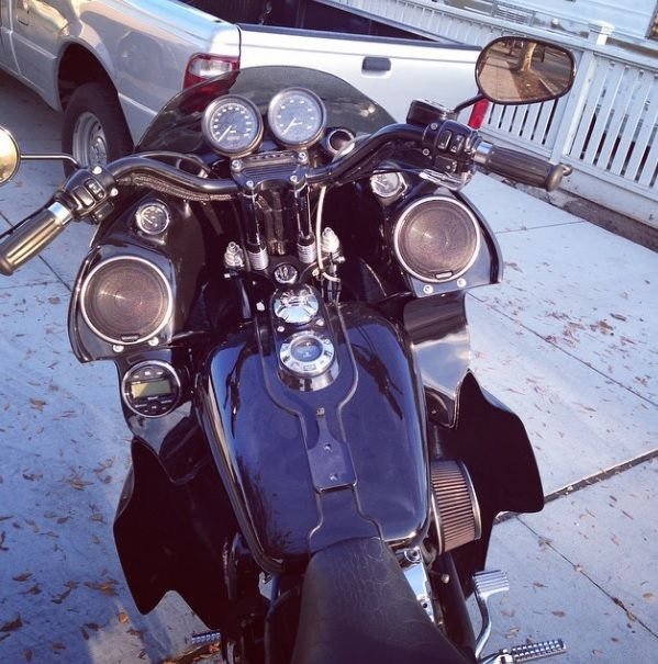

I installed one of those cup holder style radios into the FXRP fairing on my dyna...its the JBL PRV175. Everything works fine with the bike turned off but after I start the bike, the radio is completely dead.
Anyone run into an issue of overvoltage not letting the radio turn on? I'm wondering if it's the voltage regulator taking the electrical system up to 14+ volts, the radio just doesn't want to work that high.
To see if it helps, I ordered up a voltage regulator to keep a consistent 12V at the radio.
Thoughts? Other options short of replacing the stereo?
