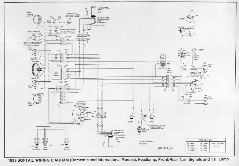

1997 FXSTC...I bought this bike and it has no front turn signals. It has rear leds with badlands load equalizer..I want to install front signals, non led...problem is the wiring for the front signals have been removed...question...where can I tap into the system to power the front signals? The manual shows a connector for the front signals under the dash, problem is the plug to the front is missing. I know I need power and ground and the flasher...again where can I tap into the system to hook them in? I read 84 pages of the forum and still have no idea...Bike week coming up...would like to be "legal"..thanks

Can I tap into the brown and violet wire at the turn signal module? and the black for ground?

Can you post a picture of the skematic?
On my 01 st skematic that would work.

Originally Posted by thegars
Yes brown, violet turn, black ground.

Thanks, got it...safe and sound and legal now!
