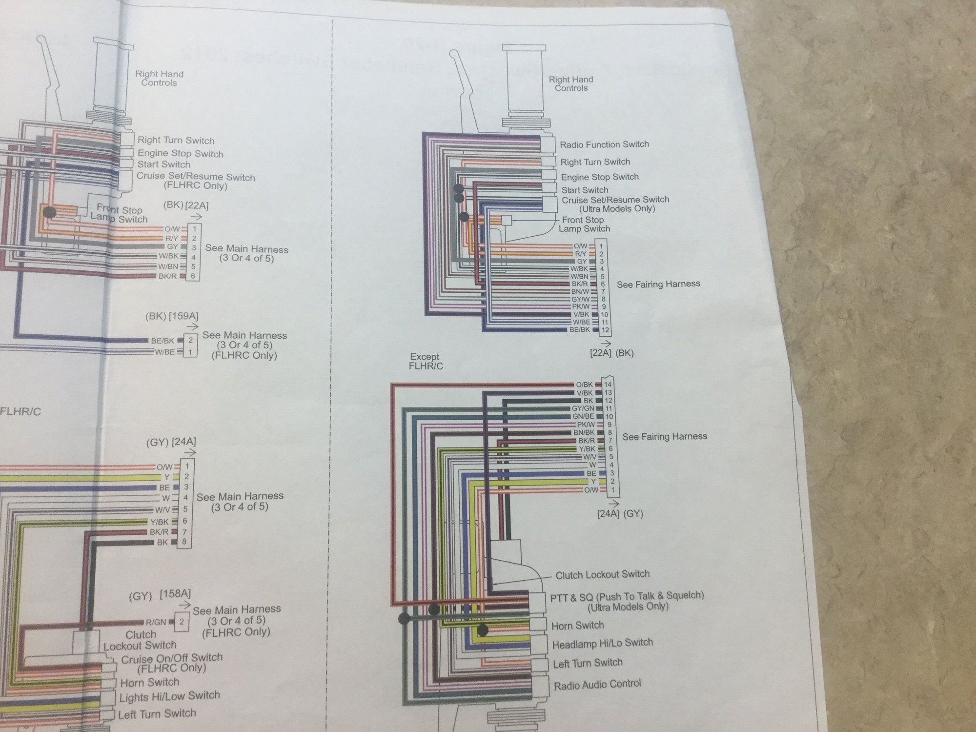

Here are schematics for your bike. Do you have a meter and know how to check voltage, continuity and resistance?
