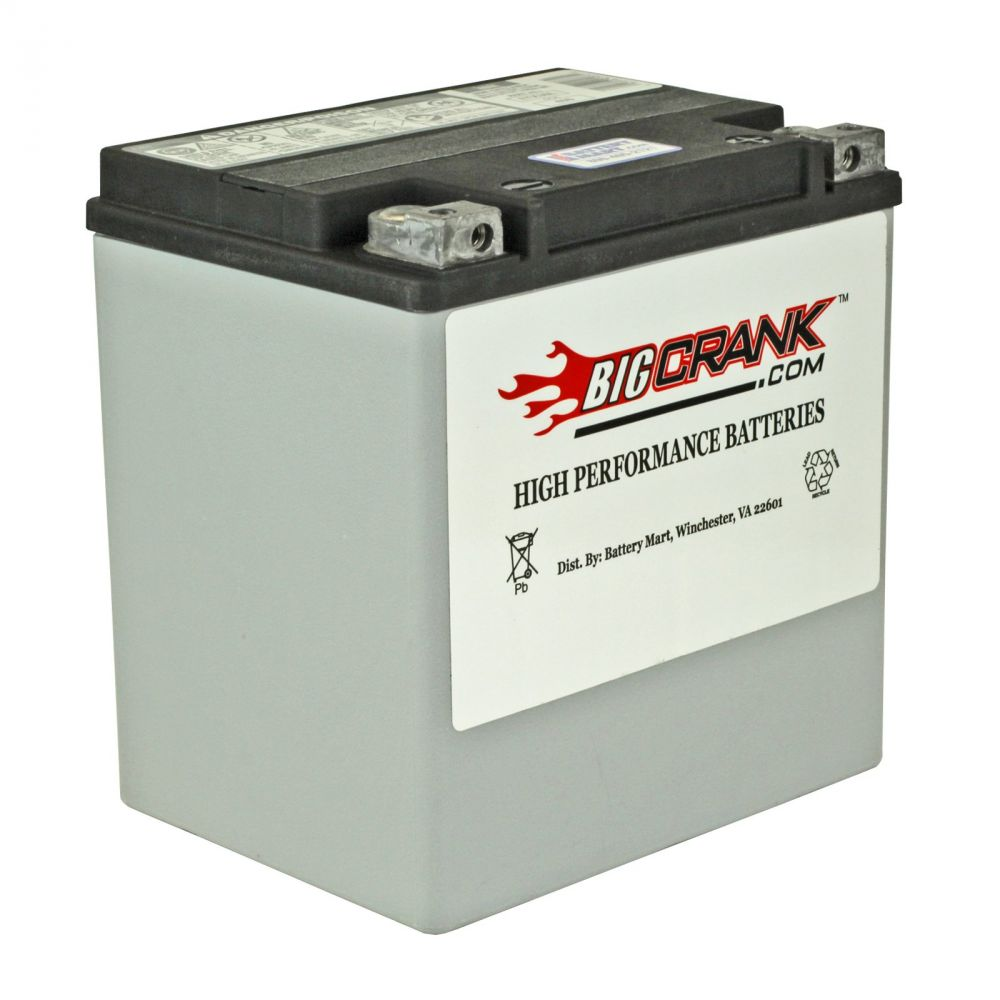

I bought a new battery last Nov. and finally decided to change it out yesterday due to winter and I always have the bike on a tender, so starting was not an issue..... The past few days it had been really draggin' to start. I was fueling up the other day and it acted like it did not want to and took 5 tries but finally did.
That was the straw that broke the proverbial camels back.
Charged up the new one(Battery Mart Big Crank) that was 8 months old which by the looks of it on the charger did not look like it needed charged but I did anyway which seemed to boost it up a bit more.
Disconnected the negative first and reconnected it last and all was good except lost all of the presets on the Sony Head unit.

I think I saw that it's recommended to do so. The Big Crank did not look like it needed it as it was about at the far end of the green as you can get in the charger gauge but none the less I put it on right before I went to bed and then got up and went out to the garage and changed it.
The one that I replaced the other day was 7 going on 8 years so I got more than money from it.lolol
Can't say enough good about Battery Mart's https://www.batterymart.com/p-Big-Cr...L-Battery.html
Big Crank ETX 30L
