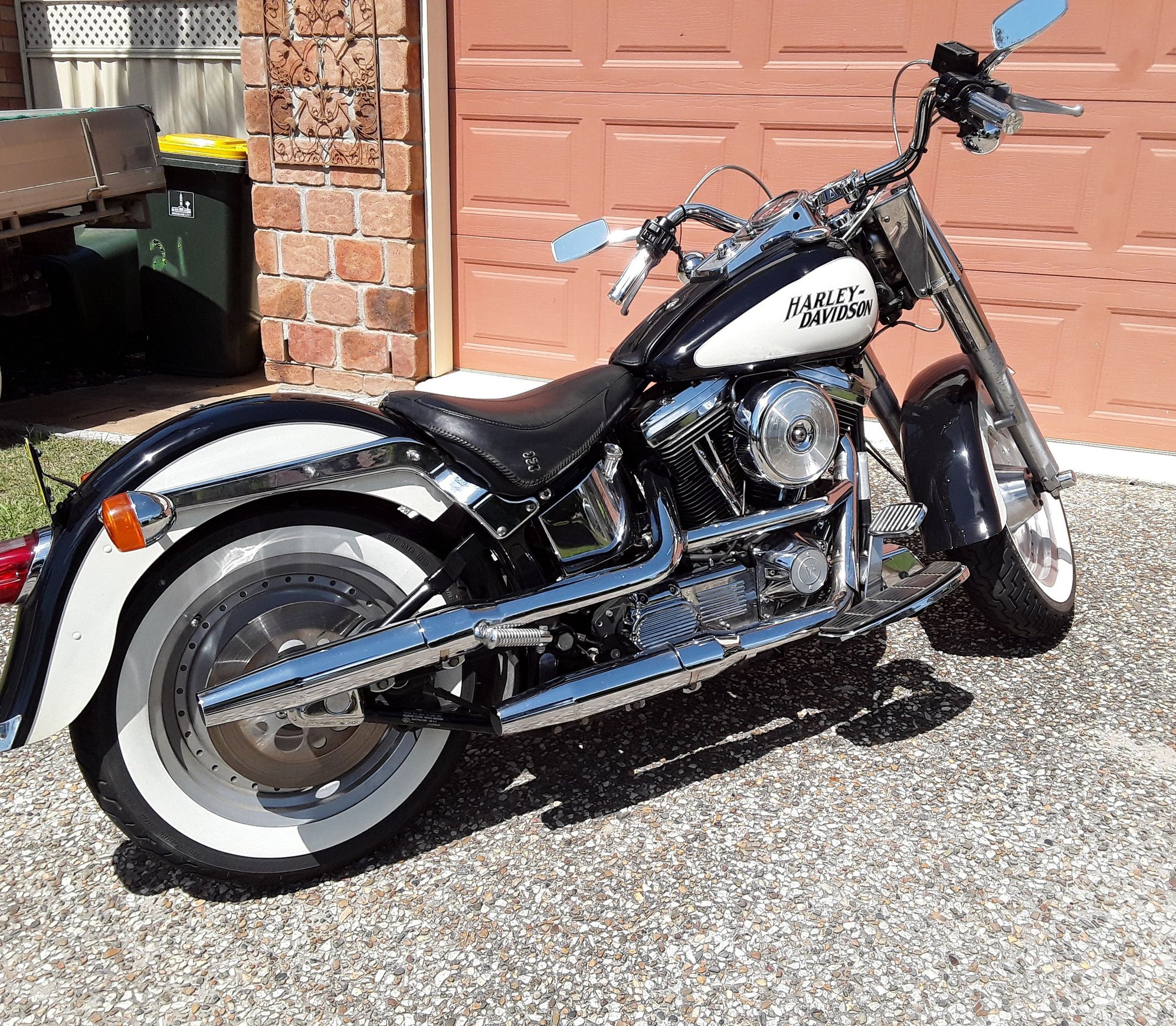

Gday to All.
The issue I have with my 1994 fatboy is that the battery loses charge while sitting on its jiffy stand.
I have a battery tender permanently wired to the battery.
When I plug in the battery tender and turn it on, with the bike switched off and parked up I can feel a tingle from any chrome/unpainted surface that I touch.
There are no fuse to check, as it's all circuit breakers and everything runs as it should while I'm out riding it. I've taken to parking it with a piece of insulation rubber under the jiffy stand to stop the voltage drain.
Who other than me has had this issue, and where on the bike in the harness was the issue and how was it resolved?
Scotty.
