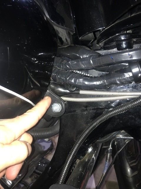

sort of. I haven't tried again, but I couldn't get it to work and realized my On/Off was in the off position. I "was" watching a video on a 2014+. I was thinking you meant the main ignition switch. gonna try again, but after watching this video, and looking at my bike, I'm leaning towards the roll-off. Mine is almost smashed between my tank mount. I put in braided lines when I customized the bike a couple years back.

Yup, that could be a problem, but you wont know till you disconnect it and try it out on the road.
Cant check something like that while stationary

I had the same problem with my roll off switch on my 2007 EGC. I unhooked just one wire on the roll off switch by the tank. The cruise control works but the light does not turn green but does show amber.
