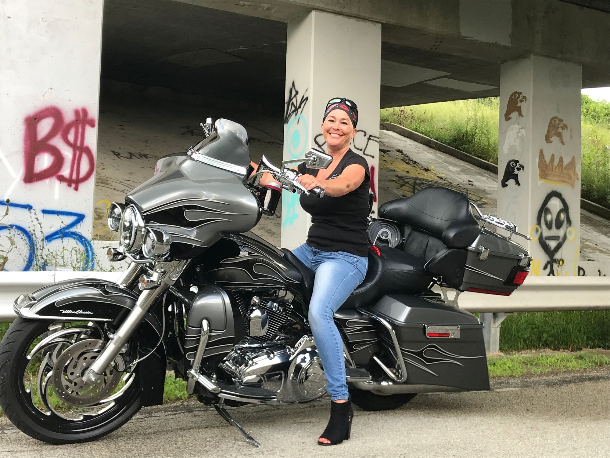

This is what we are working on. Got to get it up and going for her!!!

NICE looking ride btw!!
Yeah, he's looking at the ride. . . But yes nice looking bike!
