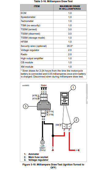

Like Cool Breeze said, charge the battery and get it load tested. If it is good run the draw test to see if something is draining the battery.
