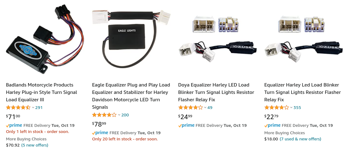

I'm going from running/signal to only signals.
​​​​​​​I can wire the originals back into the circuit with the new lights attached. Now, they flash.
It sounds like you replaced your turn signals with LED lamps. In which case, you will need a load equalizer or a turn signal flasher relay.

Yes, my bad. They are LED lights. I should have mentioned that, guess I didn't cuz I didnt want that to be an issue. Sorry. Where does this led equalizer go? Is it additional or Is it swapped out for something? Thank you everyone.

Check out custom dynamics and look for a signal stabilizer for your year, this would go between the main harness and the rear fender harness.
