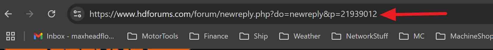

If you find something that might be pertinent to your problem why not go to the top of your browser and copy the link and paste in your thread.
