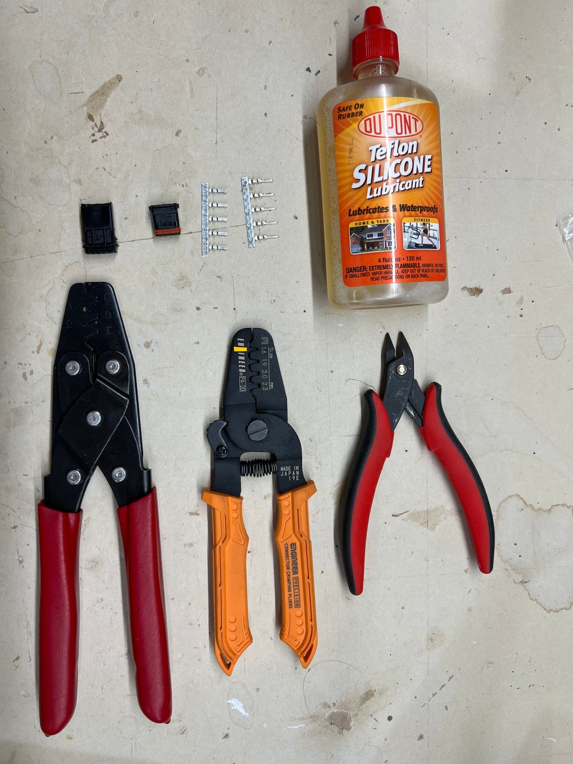

for Jae MX 1900 series connectors, I used--
Engineer PA 20 1.6 mm die for the conductor crimp
Sargent Die "B" for the insulation crimp (requires an O shape rather than an M shape for proper crimp)
for Tyco amp multilock 070
crimp with Engineer PA-21 2.2 and 2.5 mm dies
if you are over 50, get a magnifying glass with a stand, you will need it
a little teflon lube on crimper jaws helps
here's a picture of this stuff

the Sargent tool doesn't have any markings on it but I think this is it.

This helped me tremendously! What crimpers do you use for the Molex connectors found on the handlebar wiring and various other parts of the late models? Thx!
