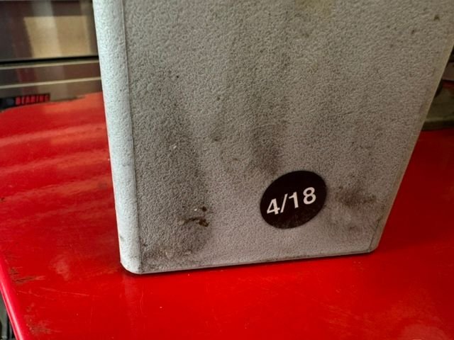

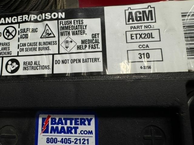

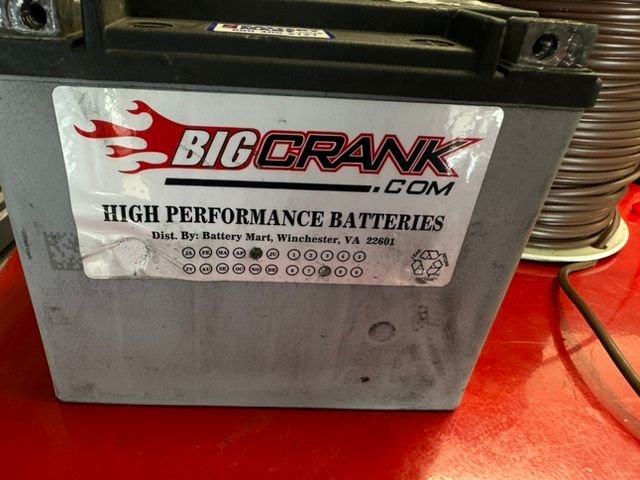

1. How old is the battery? Maybe I missed it but did not see it mentioned.
2. I just replaced a 6 year old battery in my Sportster. The battery load test showed good; however, the battery has six years of use so for some reason the tester is not correct.
3. Put a new battery in and all is well.
4. SOH reading was the only one I was believing. Readings were taken 24 hours after I took it off the battery tender.
And pictures below for reference:
