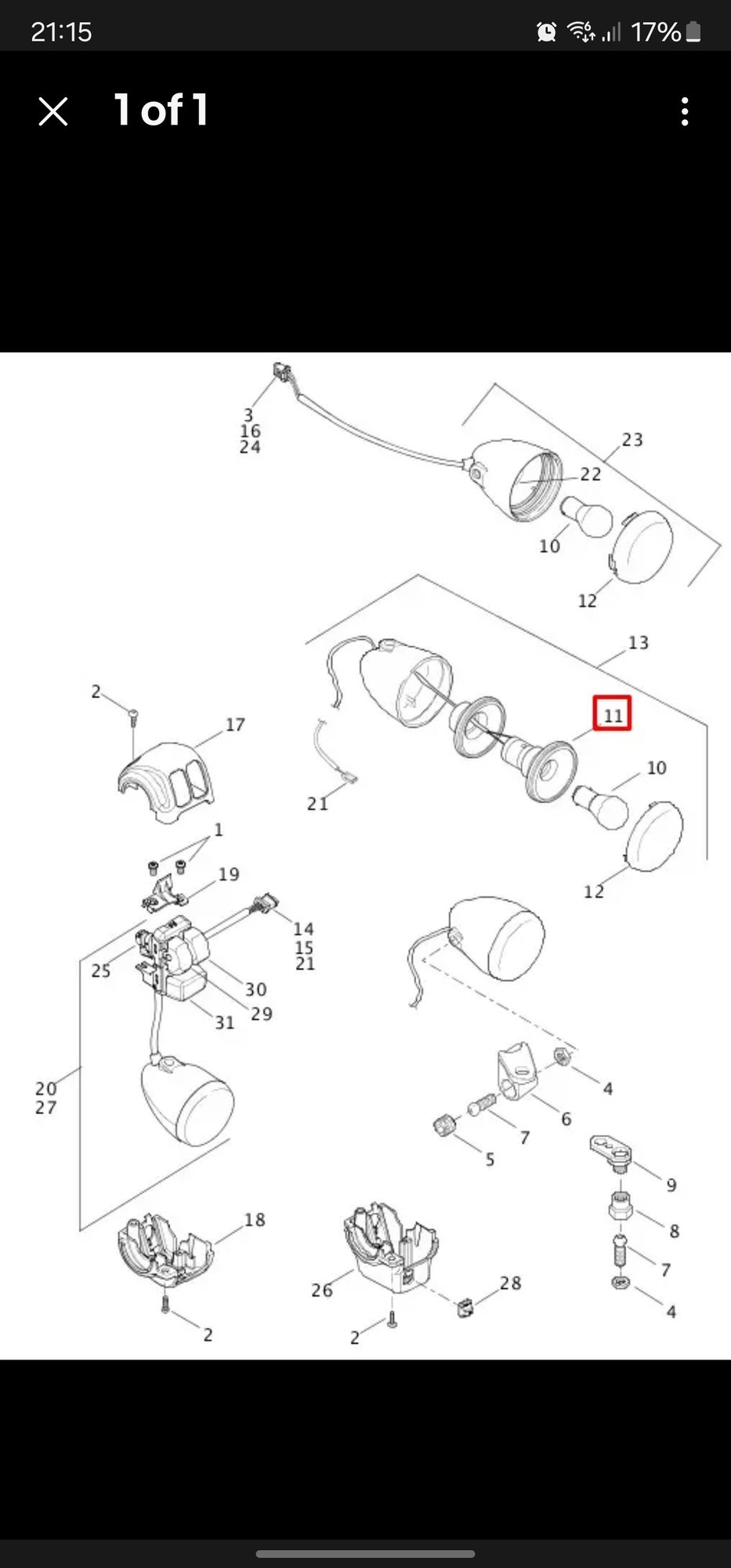

Hi please help im from the united kingdom and im trying to purchase The inserts for my HD Low rider S FXLRS 2020 front Indicators/Flashers/Blinkers. At the moment i have just the standard European inserts which only have 2 wires. i want to buy the inserts with 3 wires so i can have daytime running lights aswell and my Indicators/Flashers/Blinker. Can anyone point me in the right direction to a HD part number or a company who sells them and ships to my country. Please see attachment.
I want Number 11

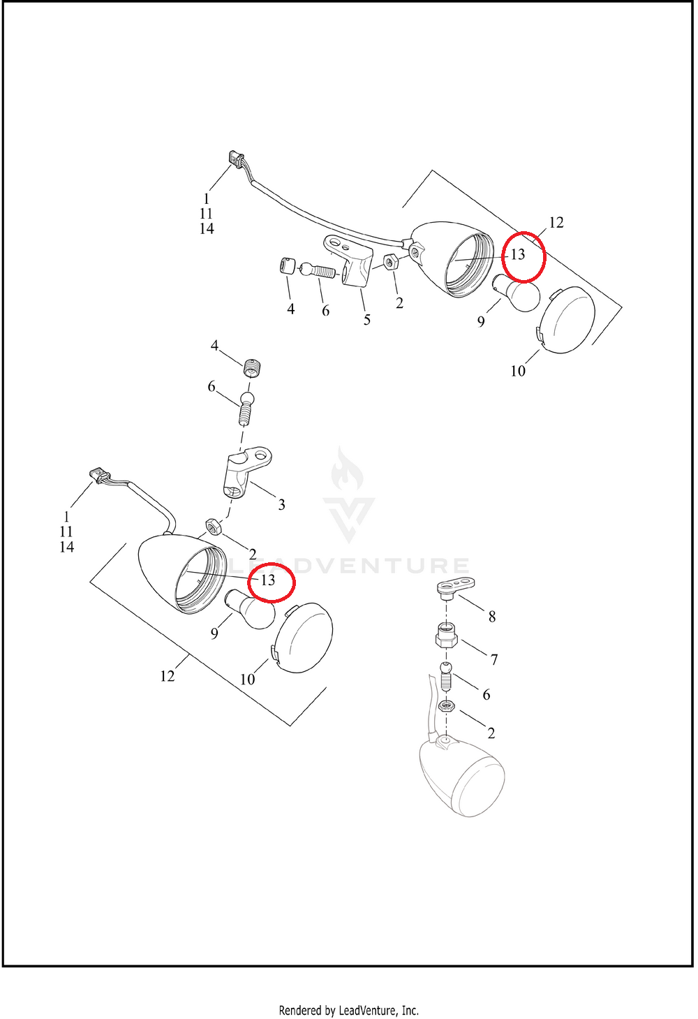

Okay, try this, go to the site link and you can access the part numbers:
The domestic may be the ones you want.
https://www.harley-davidson.com/us/e...83ef6af2b645/y
Ref:13
67800147
SOCKET ASY,FRT/DOM | (California, Canada, Domestic)
Ref: 13
67800148
SOCKET ASY,FRT/HDI | (ASEAN, Asia-Pacific, Australia, Brazil, China, England, EN2, HDI, HD3, HD4, India, IN2, Japan)

yep this is them 67800147
added 2 to my cart, says unable to purchase online, arhhhhhhhh
