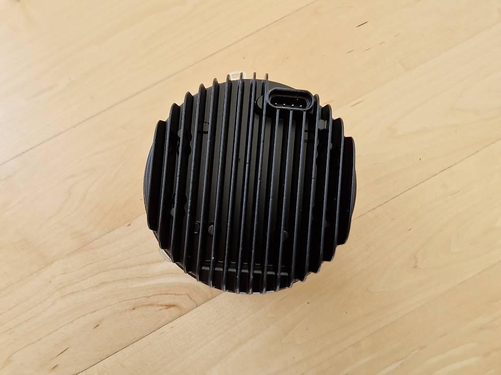

Hello,
I tried adding on to an existing thread in the Touring section, but no success so far, so here may be the more apt place to ask.
Can someone help me on the kind of Delphi connector at the back of the pictured Daymaker? I am not sure for it to be either a "150 Metri-Pack sealed connector" or a "GT 150 sealed connector". Neither one looks spot on...
Thank you, niv

It's a Metri-Pak Sealed 150. On Rushmore batwing you can connect this light directly to the fairing harness removing the existing adaptor.

Thank you very much!
