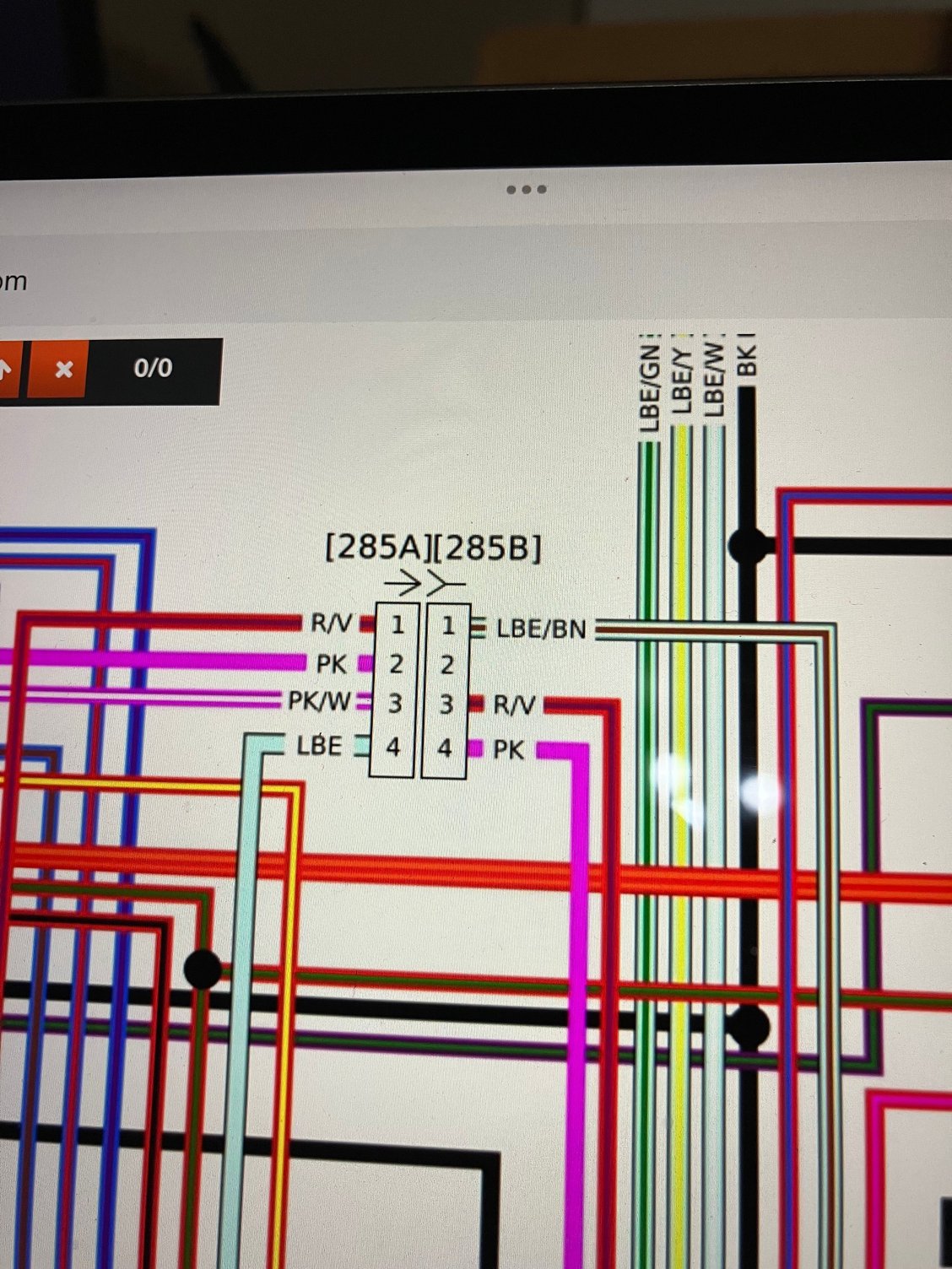

Follow up on the horn. I found the connector that needed the wires switched. It’s underneath the seat right above the battery. I should get pictures and show what I’ve done for future bike owners. The LBE wire needs to mate the Pink wire. Position four in the picture. In the police configuration it does not. In the police configuration one wire goes to the police siren amplifier, remove that wire.
