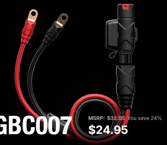

I installed the NOCO GBC007 boost adapter to use with my NOCO boost pack. It doesn't work with all of their boost packs so be sure to check the compatibility.
As others have said, the charging harness is only for charging and can't carry sufficient current for starting. On the other hand, the boost adapter has heavier cables and is designed for the jump starting.
