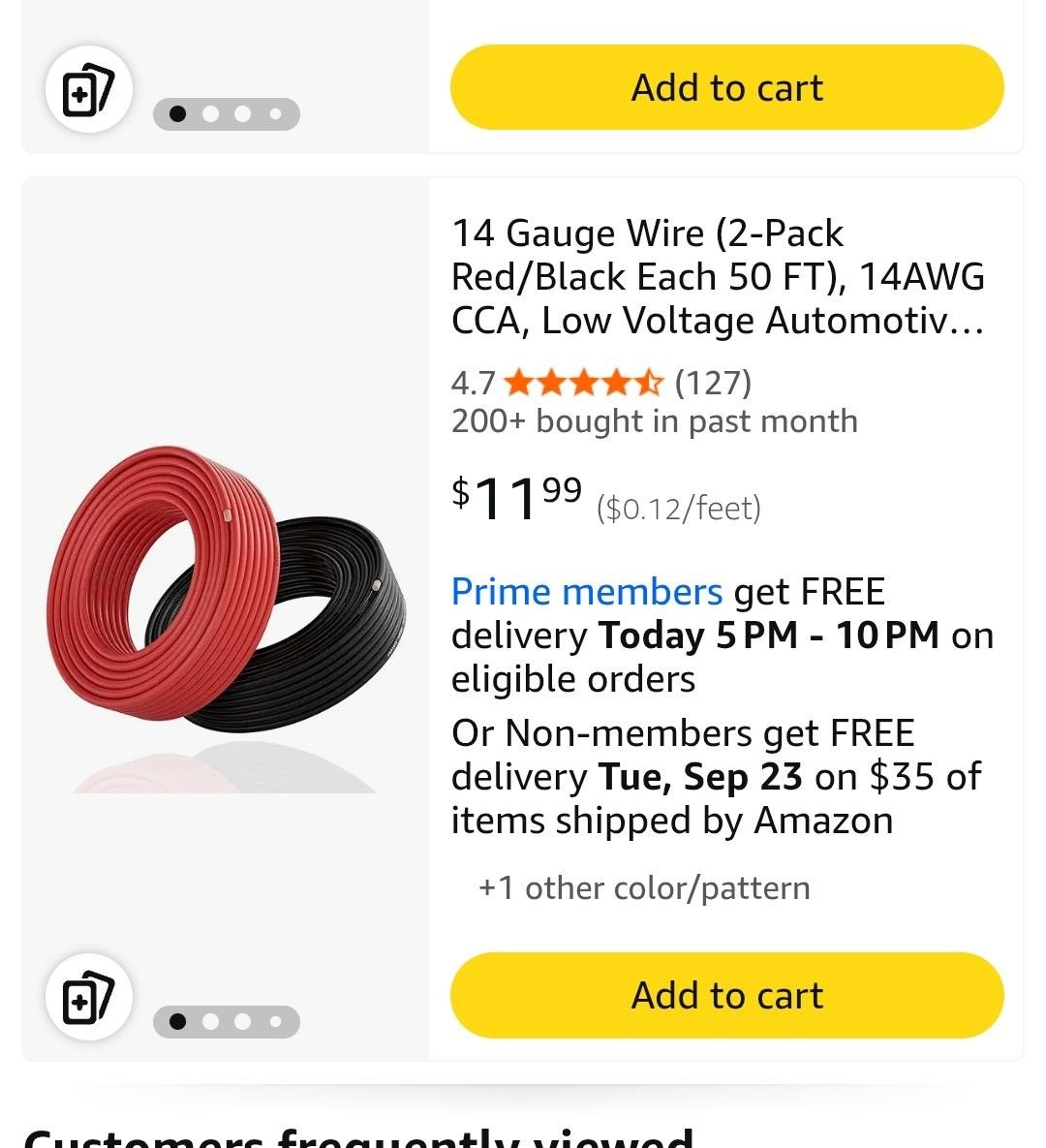

Do it the old fashion way. Pleanty of #14 automotive wire, Some 15 amp in line fuses , a switch, some ring terminals to the battery, solder, shrink wrap and tie wraps.
Now you could get fancy and tap off the head light power wire to the low amp side of the input or primary side of a relay you add.
The modern system is not going to see that I wouldn't think. The input side of a relay only draws 1/100 of a amp or so. That won't hurt in pre-CANBUS
Now the input side of a relay does have a lot of resistance. Would that trigger a fault? That answer will have to come from the modern experts.
Be neat ....Keep it legal.
