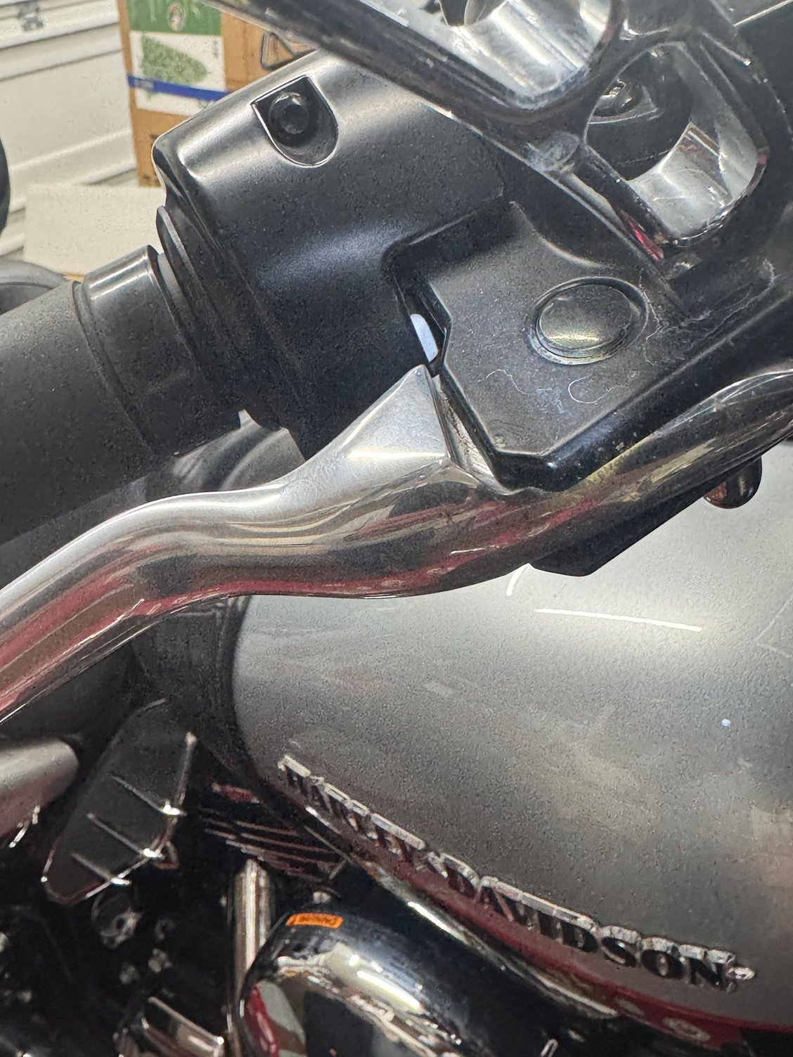

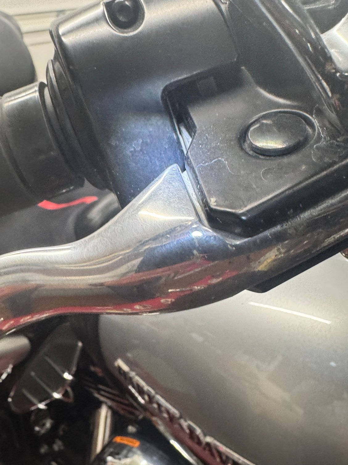

@goindeep47@hotmail.com
the second picture shows the brake lever pulled in and the switch, little white button extends out. Look at yours and see if it is working.
