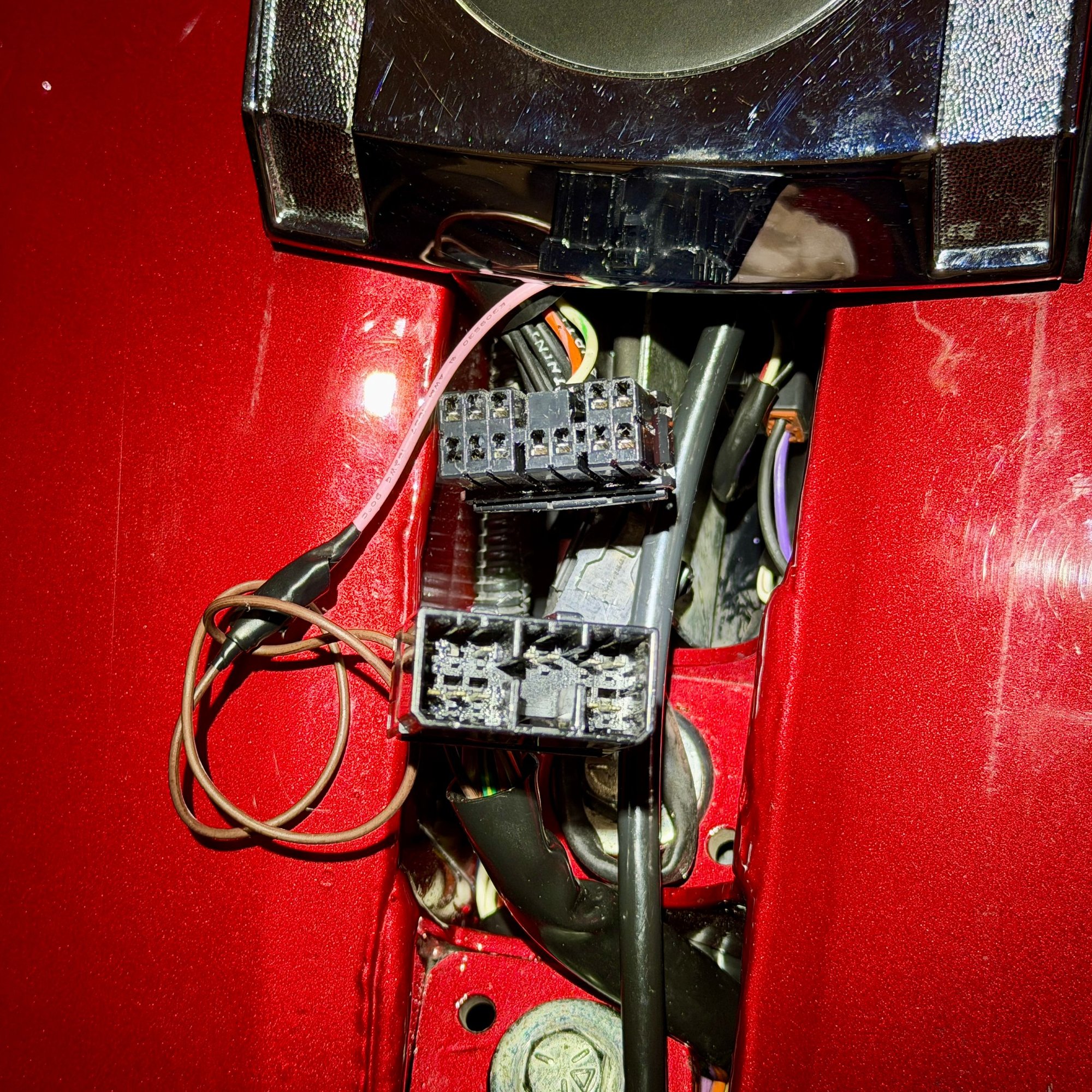

Bike is a 1999 Softail Custom / FXSTC. I am looking for assistance in identifying the type / brand of the dash connector sitting under the tank panel. Pics below...
I've got a temporary run to the a tach that I'd like to integrate into the harness connection. There appear to be two open slots. I am very familiar and comfortable working with Deutsch Connectors - this one is new territory for me.

AMP Multilock 070

Fantastic! One step closer to a super clean install.
Look like I need:
AMP Pin: 73190-96
AMP Socket: 73191-96
Really appreciate the help - thanks!

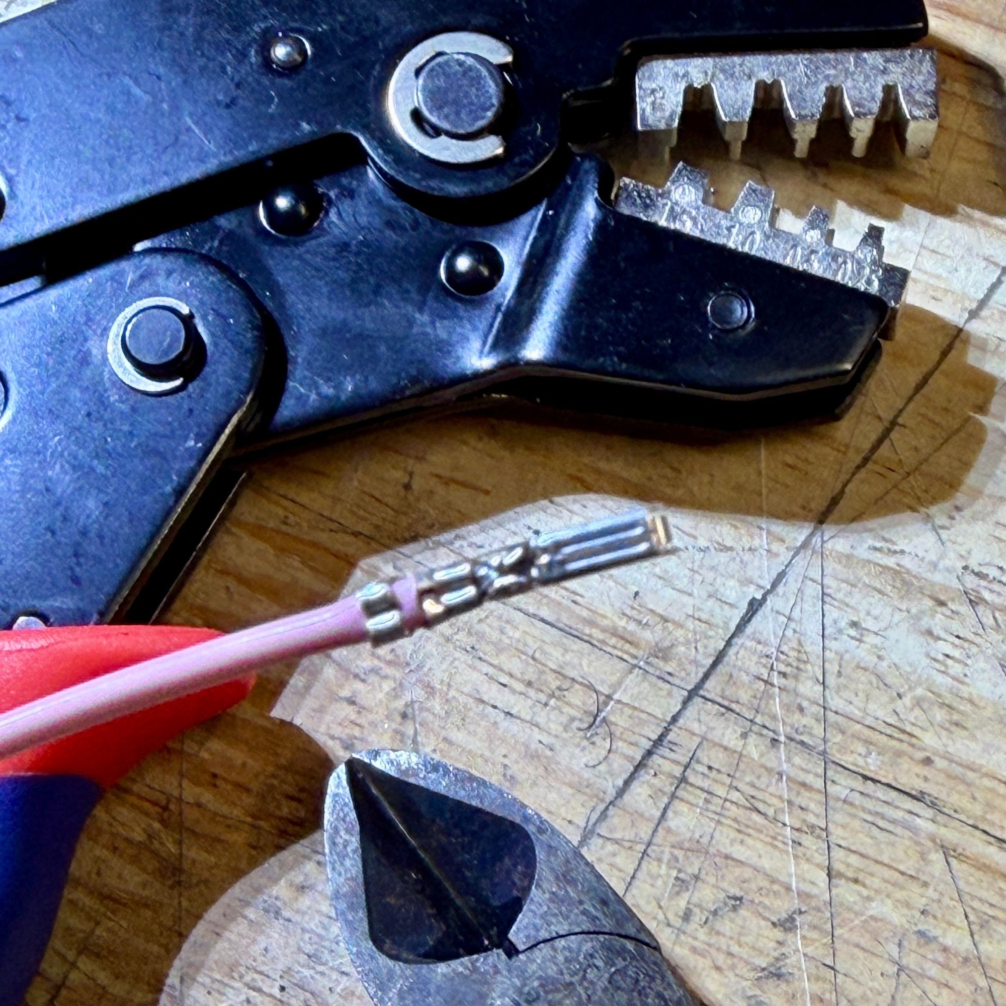

With crimper like this there will be nothing difficult. Probably need some plier adjustments on back crimp to make it fit easier into housing.

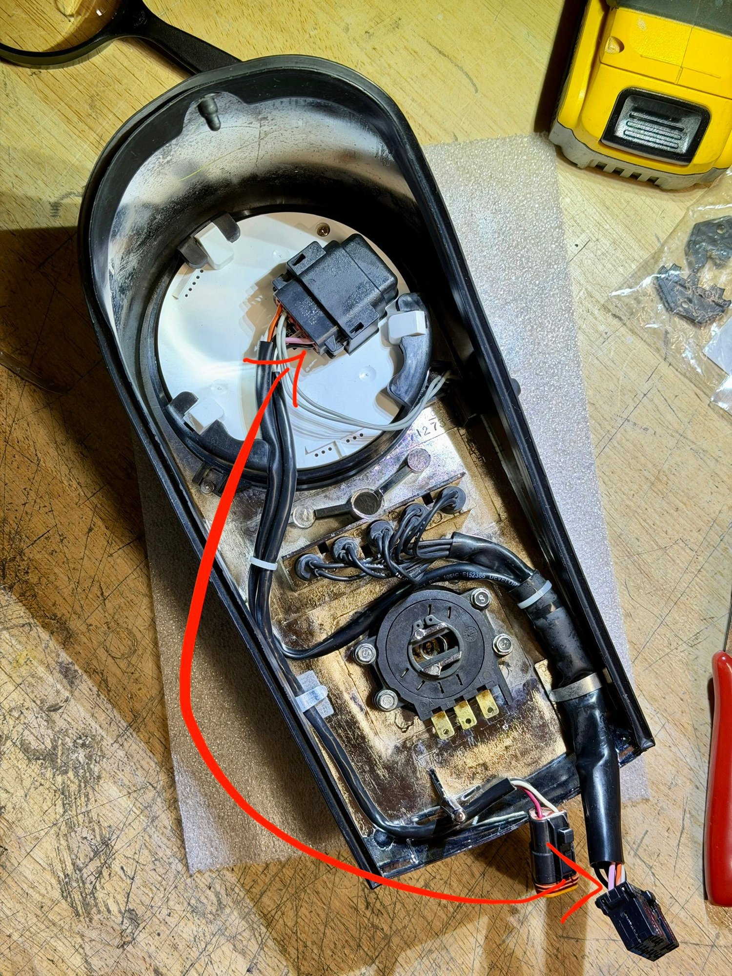

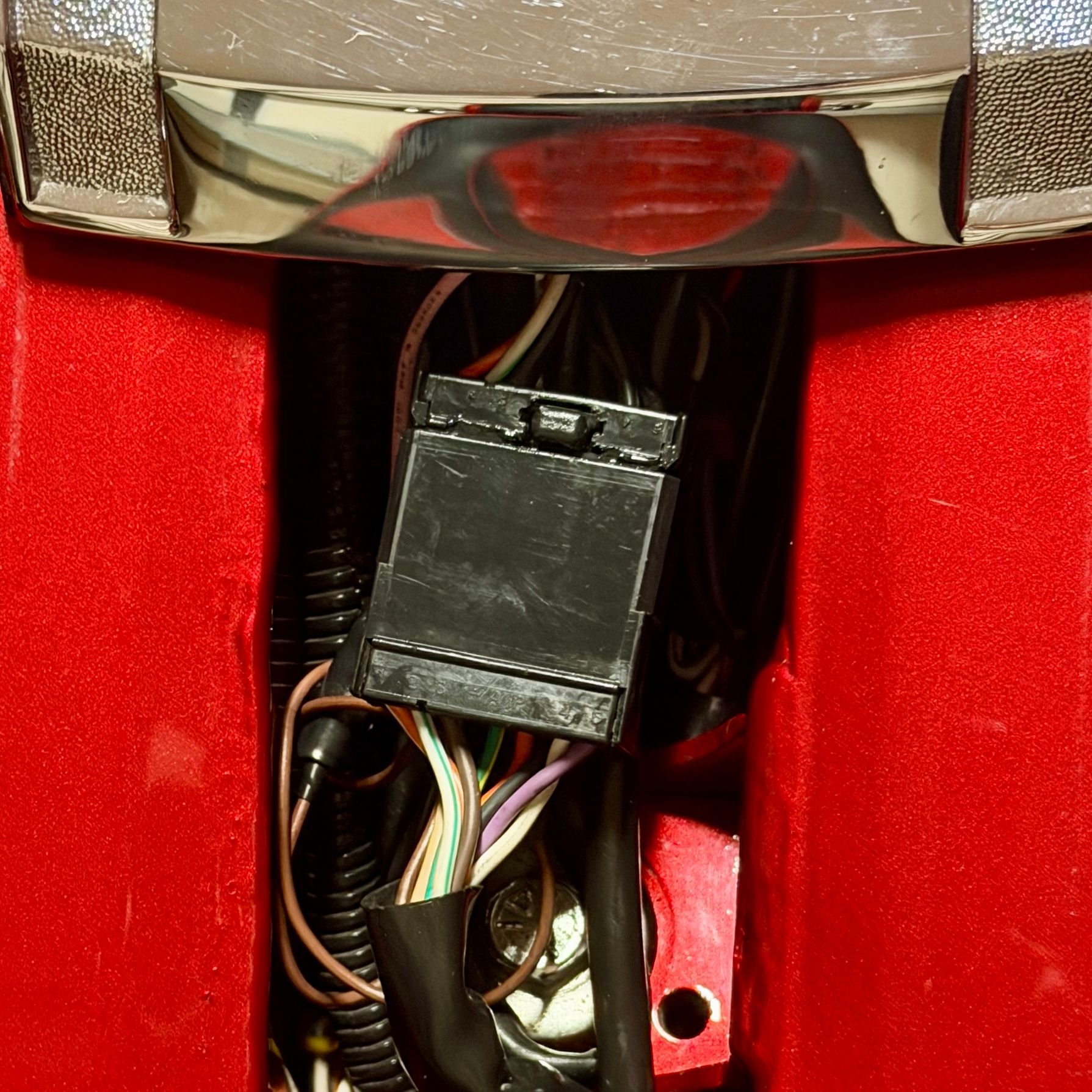

Crimper arrived and I got to work - first try!
Ran the new tach wire through the existing harness in the dash and into the AMP connector.
Similar treatment with the connector at the frame - everything buttoned-up and looking like it came from the factory that way.
