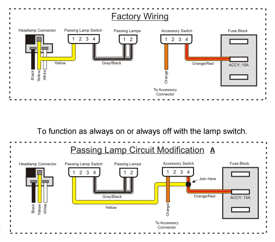

I don't know about all setups, but I think you should try it with hi/lo switch on low beam. I think most are wired to only work on low beam and when switched to high to go off.

...and you can buy a harness to keep the passing lamps on while the high beams are on ... or do some "trickery" on the existing harness ... Not legal in some states
