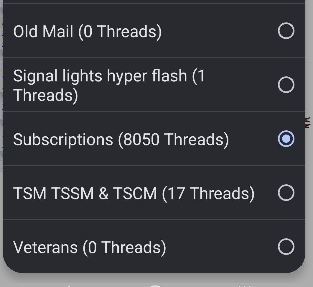

They go bad. I have 17 threads (Now 18) saved in a folder. Haven't heard they go bad slowly. There no replacement parts except the signal light non security after market replacement unless you can find a used one.
If it dies locked up, it's a big issue. I would not lock it unless I need that security awful bad.
