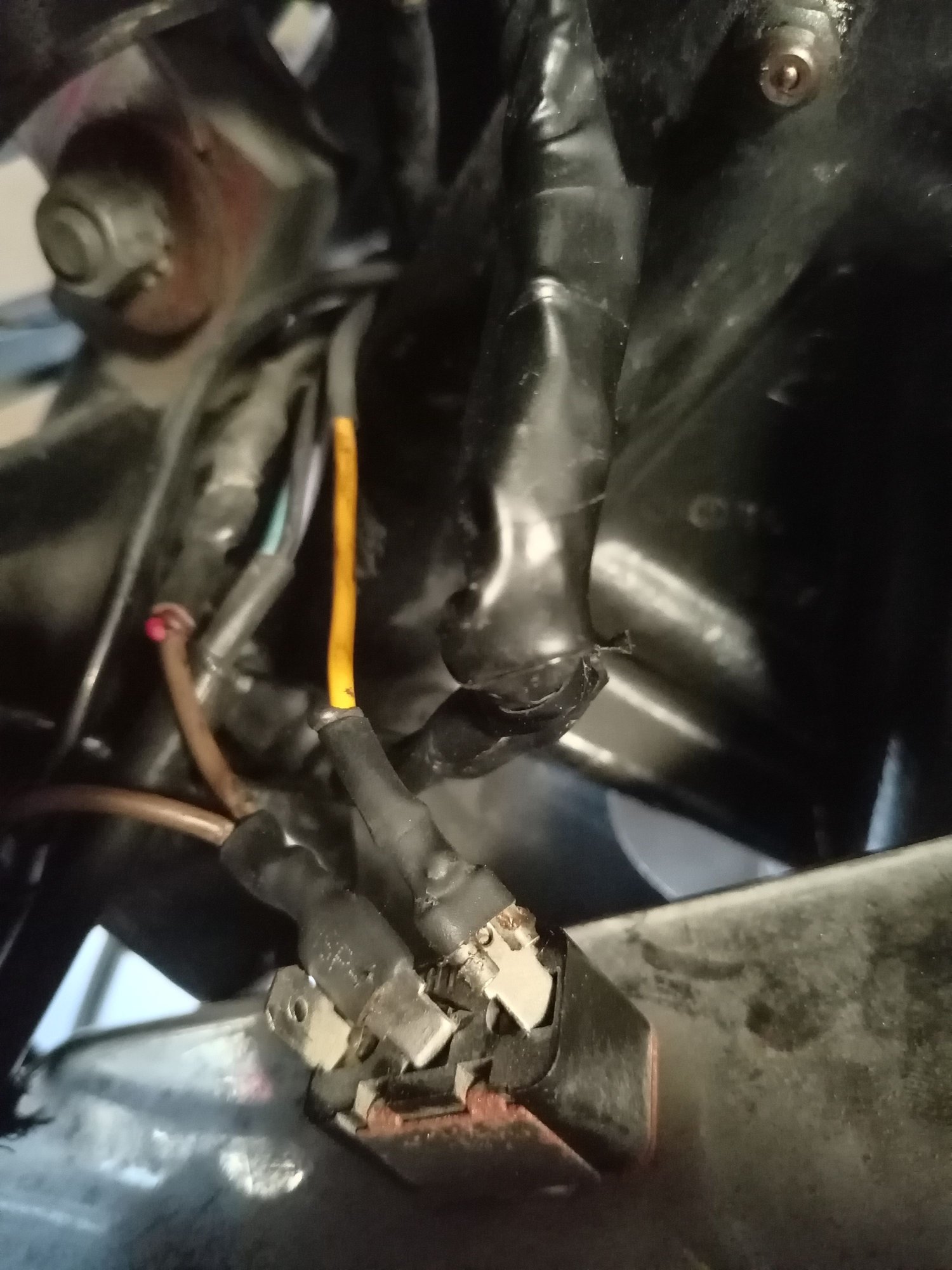

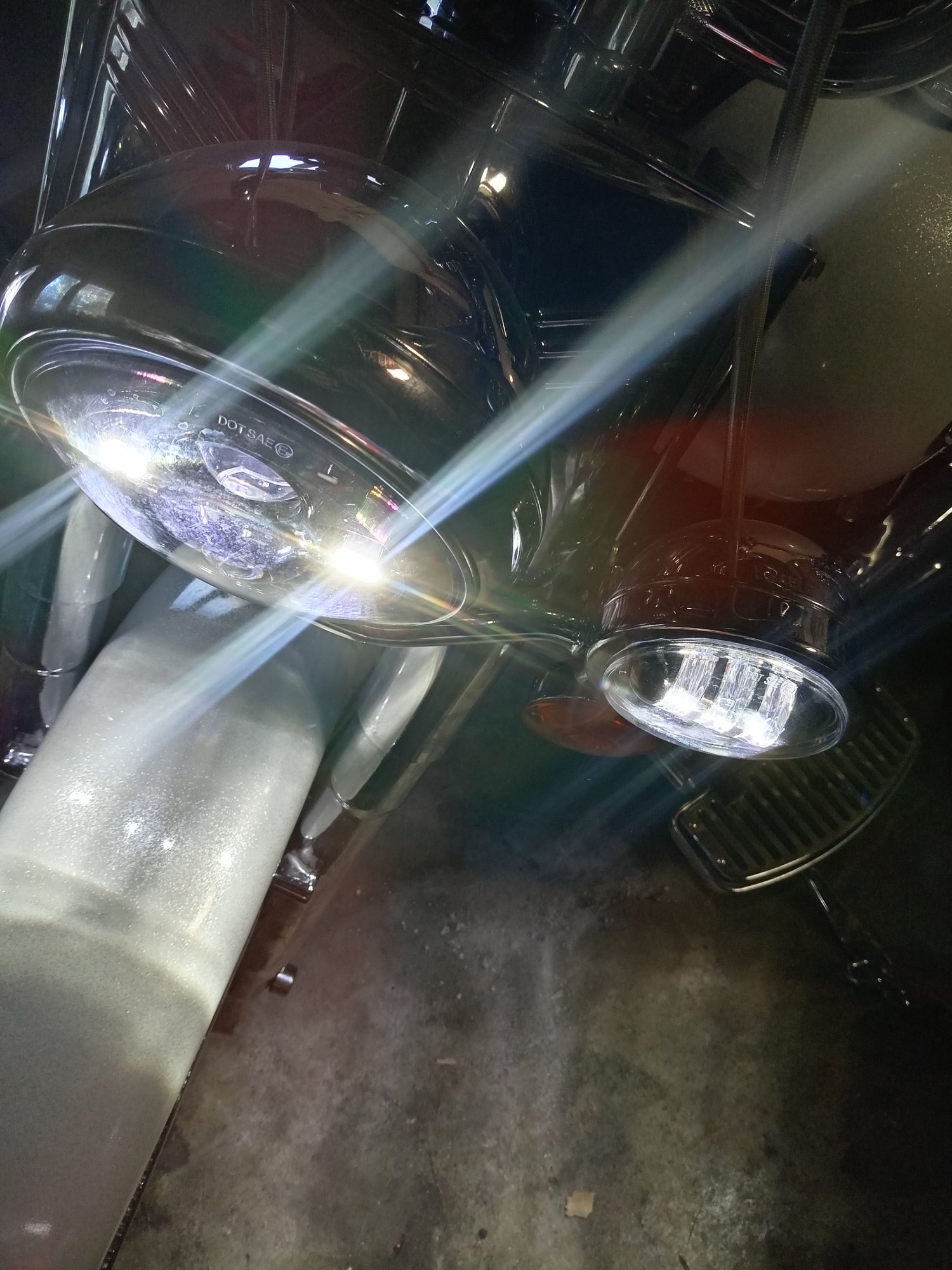

Hi
I have a problem with my new 1996 Harley FLSTC
​​​​​​The passing lights are always on
I removed the two wires from the switch, but it's still on

Someone probably bypassed so it would stay on with high beams

Yes
The brown wire seems to be connected to the headlights.
If I follow it, I'll find the problem

Orange wire comes to mind. Google this and wiring diagrams will pop up

When the bike came from the factory the aux lamps only came on with the low beam.
The aux lamp switch was powered by the low beam circuit (yellow wire).
Mine (1989) is still wired in the OEM configuration.
