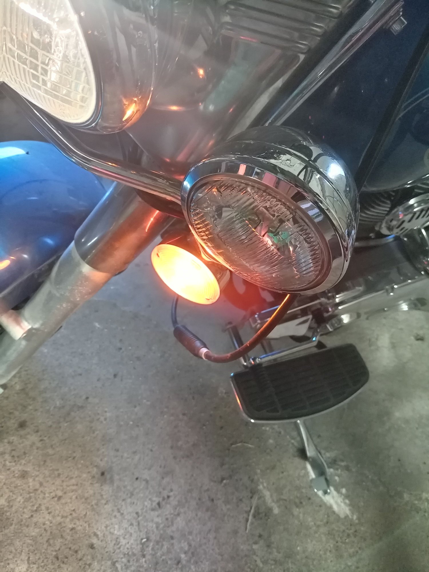

It seems to me the previous owner changed the oem wiring. This is how the oem toggle switch looks like:
Here's a part of the 1996 FLS models wiring diagram, which shows the FLSTC aux lights are powered from either the low beam or the high beam through the toggle switch
Just follow the yellow wire and find out where it leads to, probably hooked up to a relay or the yellow low beam wire comming from the harness to the headlamp.

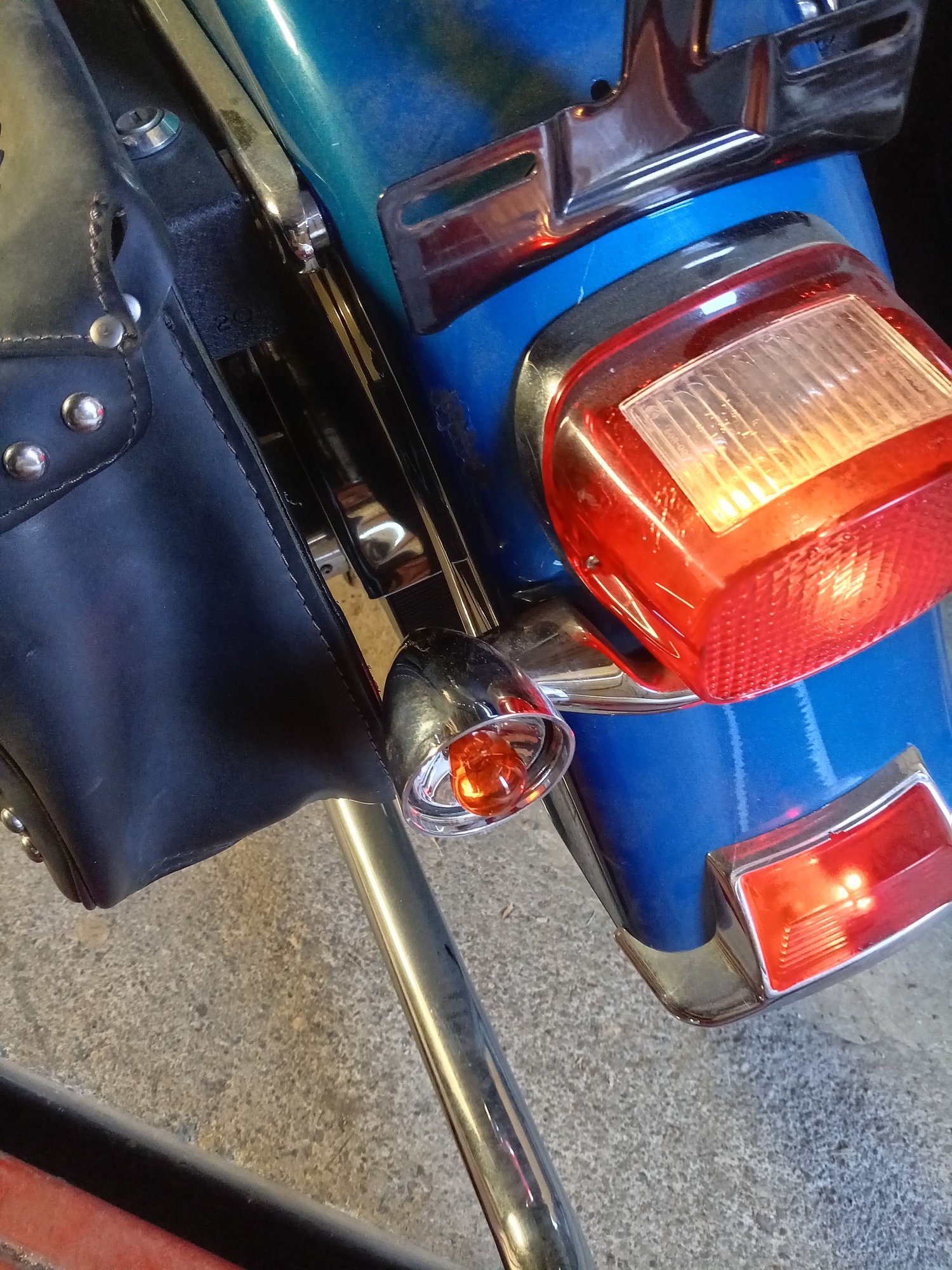

Tell us exactly what happens when you press the left turn signal button.
Left side, fixed turn signal at the front and nothing at the rear.

Ok, the front lamp gets brighter, the rear lamp does nothing, correct?
If so, have you replaced the bulb?
If so, check voltage at the contact in the socket with your voltmeter.

passing lamp problem solved
the guy had done a bypass with the dual filament bulbs(running lamp and turn signal)
no correct
no correct
correct
correct
