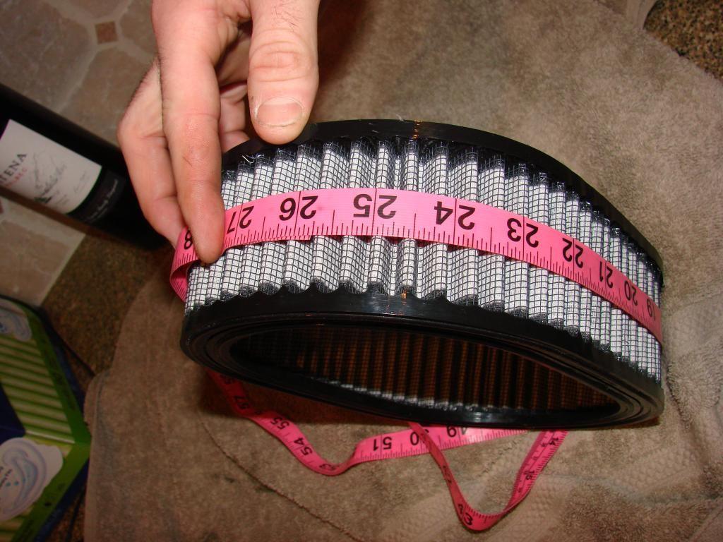

just for reference in case anyone is interested in this....i was measuring this for a pre-filter to be made for it ,,
