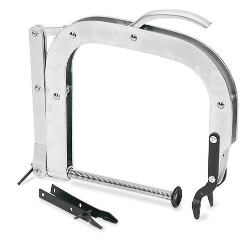

thanks kirby! it was a combination of the compressor and user error. the springs didn't want to compress easy for some reason, but they did couldn't figure out if it was the angle i was going at or what
i used one of these
https://store.snapon.com/Valve-Lifte...--P641484.aspx
