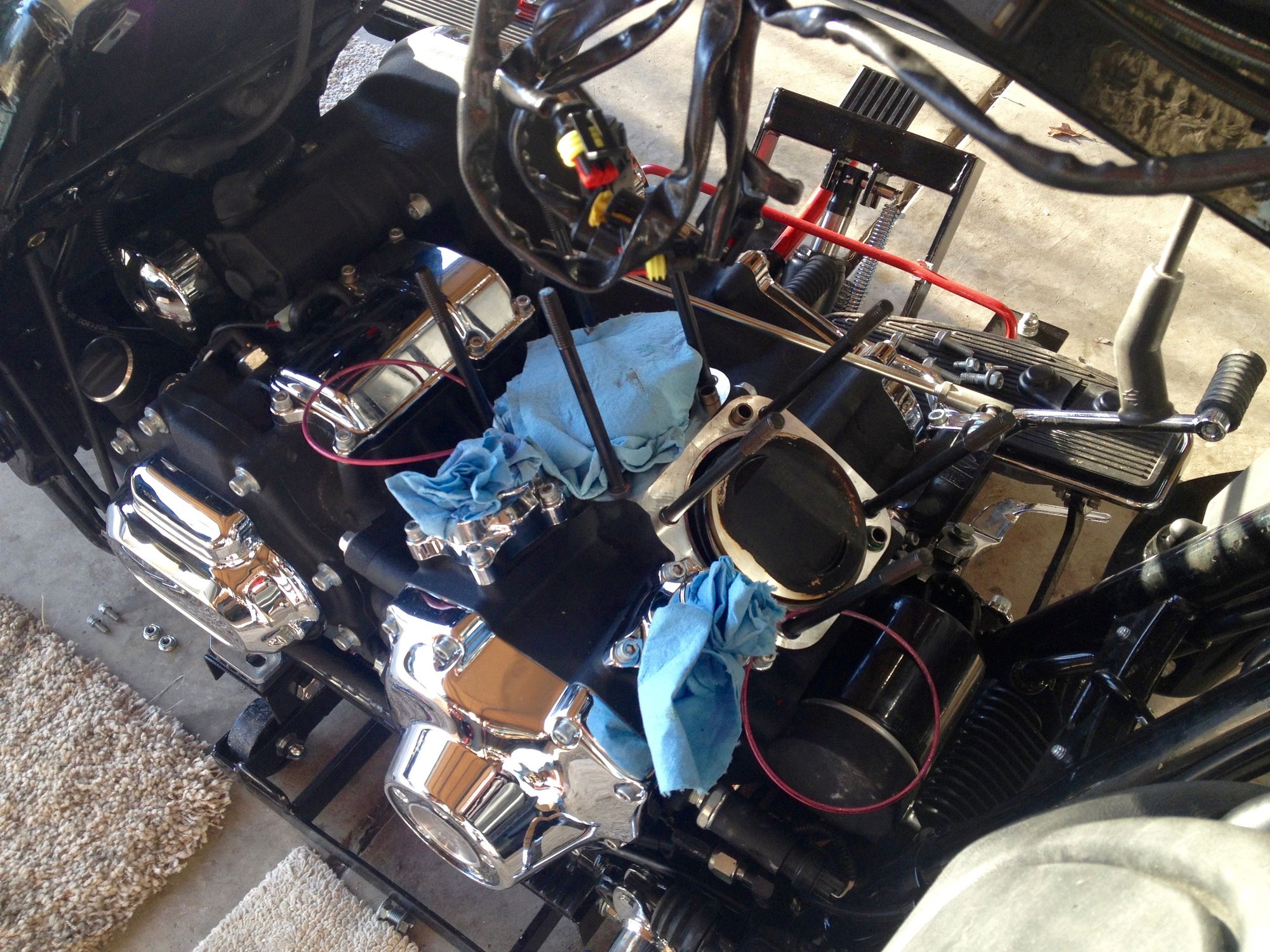

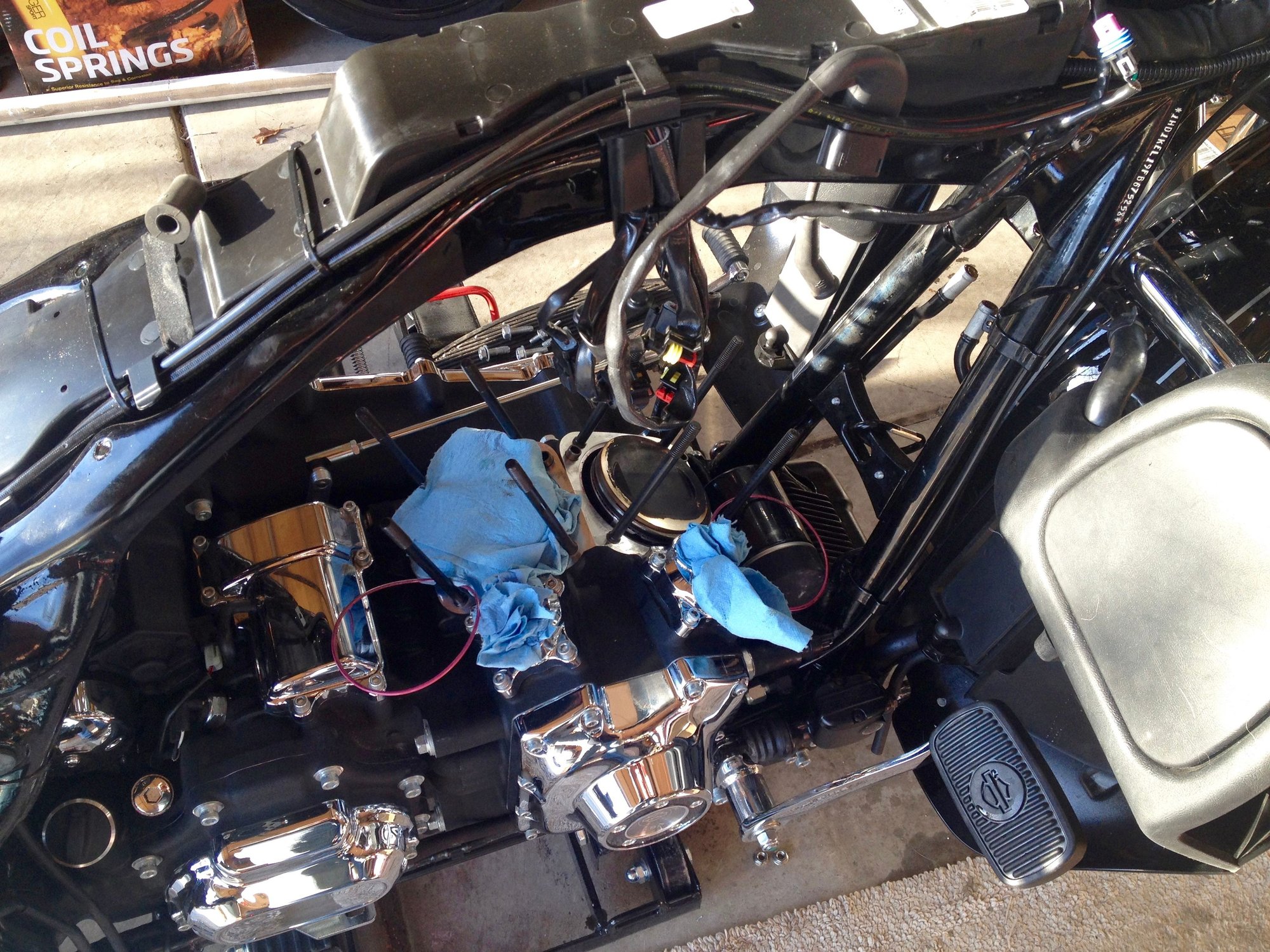

CP forged 10.5:1 with Cometic .030 head gaskets are the plan... cylinders come out tomorrow to head to the shop.
Old Feb 25, 2016 | 06:08 PM
GibsonSG's Avatar
GibsonSG
Joined: Jan 2016
Posts: 160
Likes: 14
From: North of Denver
About two weeks lead time for the bore & hone of the cylinders, gap the rings and it'll get put back together.
