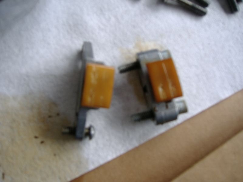

I have a 2011 sitting in the garage with double that and very little wear on the tensioner shoes. I checked them when I changed out the C lifters. Roller chains, hydraulic tensioners and better shoe material made the Twin Cam the same as most any overhead cam engine (the TC is not an OHC engine). They all use tensioners on the cam chain(s).
You can switch early Twin Cam tensioner shoes to Cyco and roller chain cams front and back and very nearly eliminate the need to look in the cam chest except for 30k intervals.
Now if you want to say a SE hydraulic conversion kit doesn't correctly solve the problem I'll agree as it retains the link chain on the back side of the cam plate.
This forum is rife with "cam chain tensioner failure" boogiemen. I pity the poor fellow who comes here trying to prevent, repair or even learn about what's inside their motor. The go to answers are "gear drive" or "sell it and buy an Evo". Post 2007 cam chain tensioner failure is very rare south of 100k miles. At 100k I'd at least change the lifters which is the perfect time to inspect and/or replace the cam chain tensioner shoes.
If you have a 2007 or newer, do first line maintenance on it and ride the thing.
If you have a 99 to 06, change the shoes on the spring tensioners, and/or switch to roller chain cams front and back. The same goes for the SE conversion, change the cams to ones that use roller chains on both sides of the cam plate.
Hundreds of thousands Twin Cams are out on the road running every day without "catastrophic" failure past 30K miles. That trumps ANY internet resume. I swear, I wish all these "experts" would stay in the "which oil should I use?" or "should I get a get back whip?" threads
I've seen 99 - 06 TC's with north of 50,000 miles and the tensioners are still in good condition. Worked on a 02 TC with 72,000 miles, the tensioners were still in pretty good shape, the inner was great, the outer had some wear which the owner wanted to replace it while it was open.
Last winter I had my dad's 09 Triglide apart to freshen the top end, put on some ported heads and swap cams. At 50,000 miles his tensioners were still in good shape, had a little wear but nothing to be alarmed about.

Opened up my 07 Fatty around 30k miles to do cam and lifter swap. Cam chain shoes showed only slight grooves. BUT, as I was probing one of the grooves to feel how deep it was, a big chunk broke off the shoe. So, while they did not LOOK worn the material was very brittle (only on 1 shoe-don't remember which) This may have been due to to overheating the bike when stuck in traffic (think Daytona Bike Week) Not sure. I have always used synthetic oil.
Any who, it was super easy just to replace the shoes with new ones. Cheap and eased my mind for a good while...at least until the nest upgrade!
