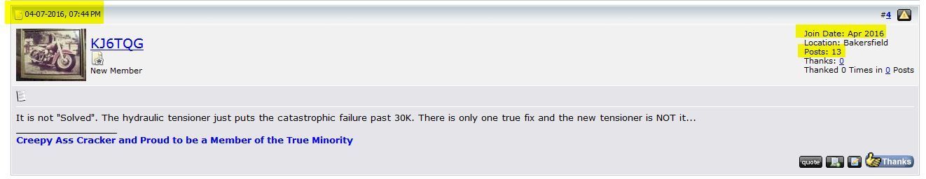

I find that on "forums" in general there is usually a direct correlation between the statement made and areas highlighted below
More Reading/Learning is in order...less assertion
Btw Nomadmax, Nice Podium speech
