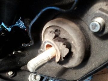

Old Aug 18, 2016 | 11:44 AM
stoneybagger's Avatar
stoneybagger
Joined: Jul 2015
Posts: 3,615
Likes: 667
From: playing with madness
Default found the problem
it was the motor mount.
thanks for posting this tread.
