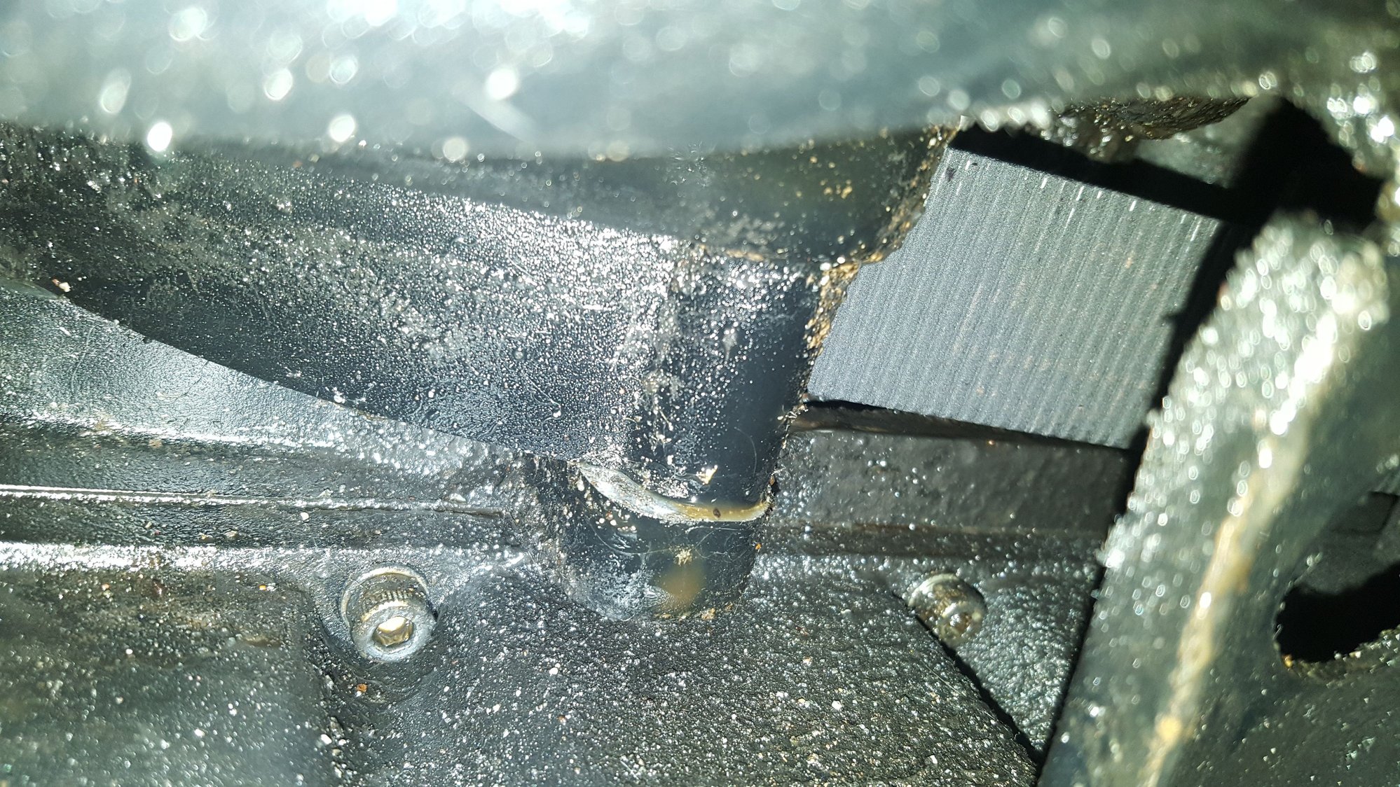

Thanks djl, some good info there. The whole area is covered by oil, so it probably is the main primary seal.
looks like I may have hi the case?

Still hard to tell until you pull the inner primary; then it should be obvious.

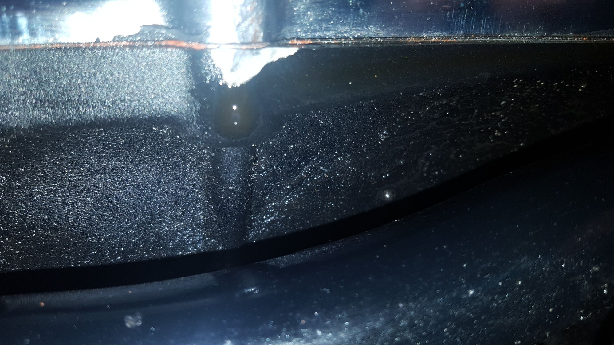

After I got home today, I wiped down the underside and propped up the bike. Let it sit for a few hours to check for drips.

More...

I had a leak from the inner primary seal, turned out it was a cracked race. replaced seal, bearing and race.

Roadstar, the leak is not going to go away. You are putting off the inevitable, order the parts and fix the leak.....
