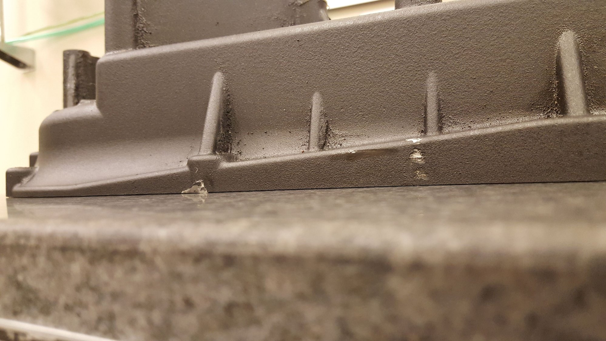

0.010" feeler gauge will fit under part of the case - is this too much? It should seal with a gasket in place, correct?

Re read post 22
