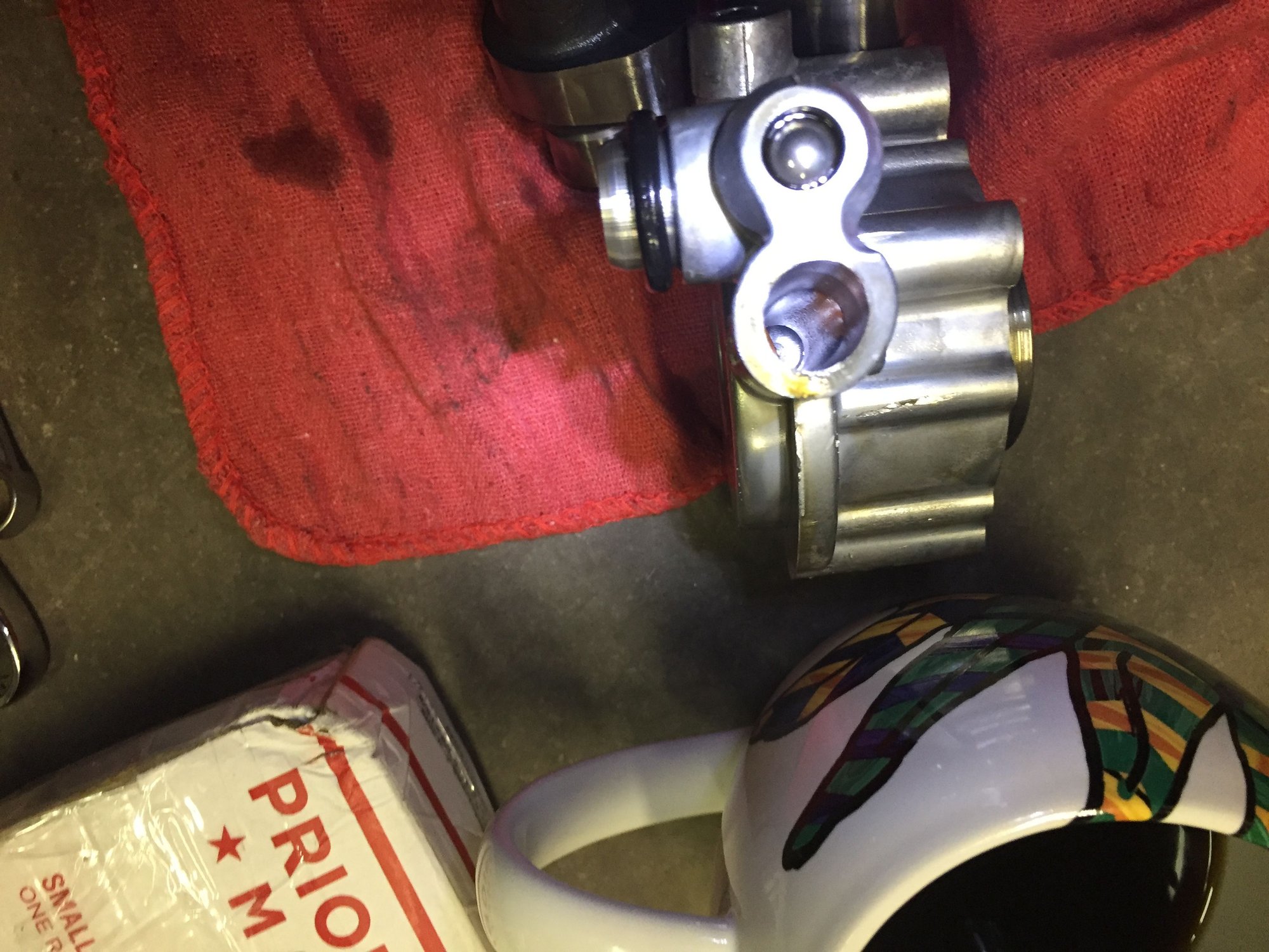

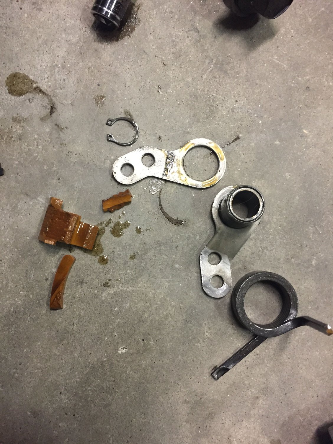

Pulled the cams to replace tensioners and there is a piece of tensioner in the pump. The pump was working fine before pulling cams out.

What do the gerators look like?

The gerators look great. If I can clean it out and know nothing is in where I can't see it I would feel comfortable putting it back in.

you really need to post a pic of the internal bore. Also, remove and clean the pressure relief spring/plunger assy. Just one small chunk in there will cause it to stick. If the cam plate has the removable cleaning plug, remove it and spray/blow with air. If not, do the same.

When I say spray i mean bomb it with carb cleaner then blow with air.

I removed the cams and the spring and bypass piston. Besides needing cleaned out it looks like I lucked out by taking it apart now. The gearator pump side, thin one, has a rough surface around outside edge about 1/8" wide. I wonder if it's normal for 27000 miles.

Looks a little rough. I don't think the SE pump is that expensive.

Cheap insurance to go new.

Yup. A little extra oil pressure and volume to boot. Not that they need much to begin with.
Will you be going with the Cyco tensioners?
