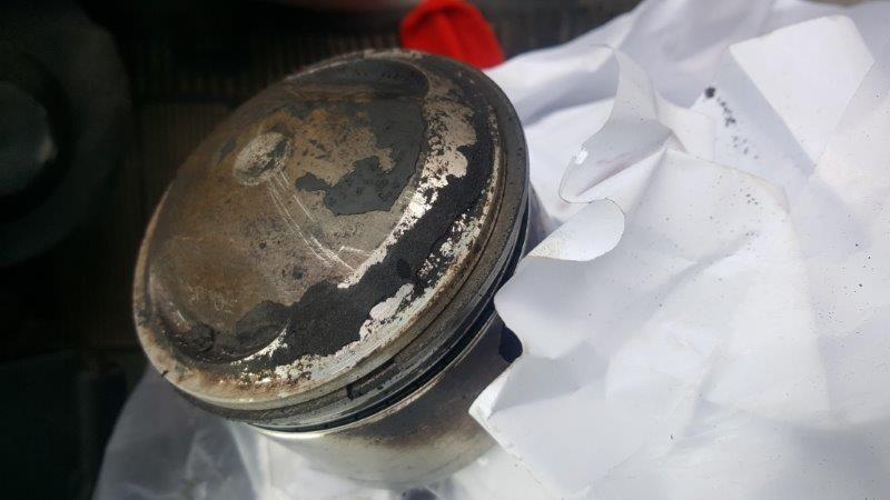

Can anyone tell me if these are S&S pistons? I can't find any mark except the .030.
I went to order rings but they're different on the S&S than other big-bore pistons.

Probably not.. SnS does not mark oversize on the tops of the pistons.. The vibra-etch it in the bottom near the piston boss. At least that the way they been doing it for the last 20 years on the pistons I've seen/used..
You might want to include year and model HD (shovel?).. Size of piston also.. You might be able to get a ring set from Hastings.

they are just cast,OEM type aftermarket pistons.drag,cci,midwest,mid usa will all have rings,measure to see if its 74" or 80" & I can get you a part #

S&S does not stamp those in that location, not even back in the TRW days.

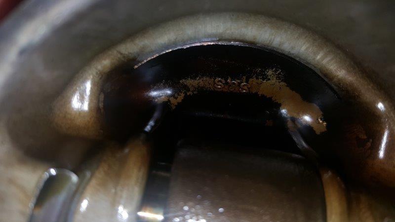

I called S&S tech. He agreed that they generally stamp the overage on the bottom inside of the piston. He also told me that I should be able to find a part number. I couldn't see anything, even with a little flashlight. Then I tried taking pictures. This was kind of amazing:

Wow,those are some very old pistons
