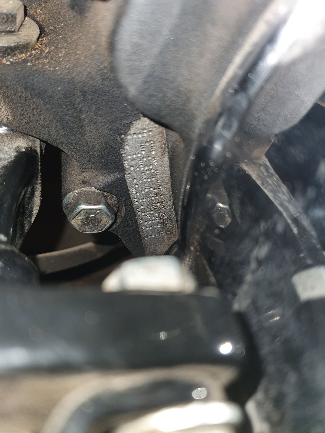

Hello I just bought a 97 bad boy in Germany and am trying to legalize in Portugal
Worried as the numbers on engine have nothing to do with VIN
number left side under cylinders * BMLX031161*
Number left side behind foward control 1599315011
Old Oct 20, 2025 | 04:04 AM
eighteight's Avatar
eighteight
Joined: Oct 2019
Posts: 10,795
Likes: 7,422
From: OH
#`s on left should share some characters with the frame number
Disregard the #` on the right
Old Oct 20, 2025 | 08:21 AM
14GuineaPig's Avatar
14GuineaPig
Joined: Sep 2013
Posts: 3,490
Likes: 610
Looks like it could be a 1999 FLSTF
BM = FLSTF
L = Carbureted
X =
1999
